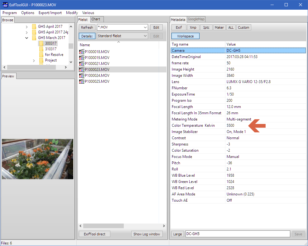

I try to find a way to see the color temperature in Kelvin after manual white balance on a white slate or grey card. That would be handy to match with other cameras. Any ideas?
Tobias Meinken is offline   Reply With Quote
Old May 17th, 2017, 03:43 AM   #5
Location: Stocksfield, England
Posts: 86
Re: GH5 White Balance
I suggest ExifToolGUI which I have been using for some years now, here is a screenshot.
This is a small list at the moment as I have not had time yet to populate it more for my GH5. It can show a huge amount of Exif data if you need it.
Claire

Thanks Claire, good advise. But it seems there is no way to check it right away in camera to match cameras on set.
