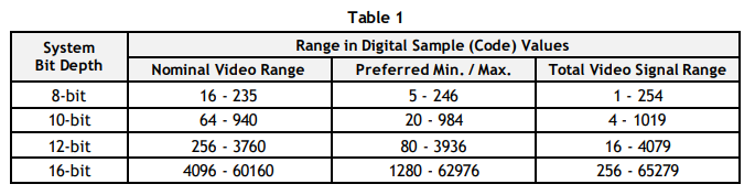

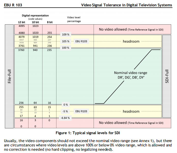

It really depends where your footage is going whether you use the 16-235 or 64-940 levels. If you were going to have to go live to air with a camera then that 64-940 would be the appropriate setting to use as that meets broadcast "Video" 709 standards. That's the level used on broadcast TV cameras.
For all intents and purposes, you might as well work 0-255 or 0-1023 if the footage is going to be edited for any kind of delivery medium. In Resolve, for example, regardless of the levels of the footage coming into Resolve be it 0-255, 16-235 0-1023 or 64-940 Resolve will convert it all to data levels of 0-1023. Any incoming 0-1023 footage will remain at 0-1023 as that is the data level range that is used internally by Resolve. If you are working in a video level timeline the scopes will read 0-1023 even though what you are actually seeing is a 64-940 range. Basically in broadcast terms, this Resolve 0-1023 range is equivalent to the broadcast IRE range of 0-100. In 10-bit that's a data range of 64-940 or in 8-bit 16-235. Or on the other hand, you could be grading for HDR with HDR scopes. Whichever way you look at it the internal Resolve data levels will always be 0-1023. When you have finished your edit and want to deliver your program, again let's say in Resolve you would on the Delivery page make sure under "Advanced Settings" that your render setting was set to "Video" as this "Deliver" Tab setting is what determines your final levels be it Video or Data. 99% of the time it would need to be "Video".

Summing up. I would only shoot 64-940 for live or for files that are going straight to air when there is no time for level adjustments. Check out the attached images from the EBU for a bit more clarification.
https://tech.ebu.ch/docs/r/r103.pdf
