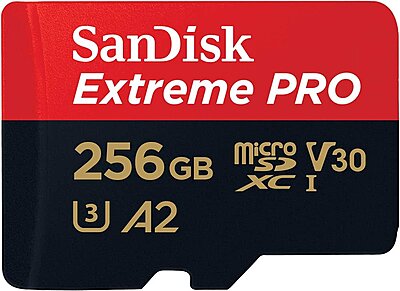

Old February 3rd, 2024, 01:28 AM   #14
Location: Rome Italy
Posts: 689
Re: Mix clips between a small camera and GH6. I'm looking for info

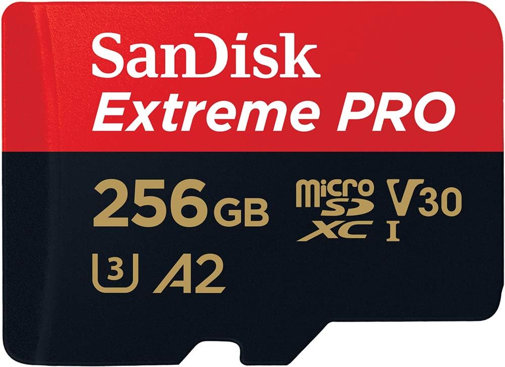

Originally Posted by Tony Neal View Post
You need the second one, designated U3, for 4K 50p recording. I've never had a problem with Sandisk Extreme SD cards.
Since the price is not much different, do you think the "PRO" of Sandisk version is even better? Thanks again.

Old February 3rd, 2024, 10:25 AM   #15
Vortex Media
Location: Florida
Posts: 3,563
In 2024, I wouldn't spend money on any card that is not at least V90.
