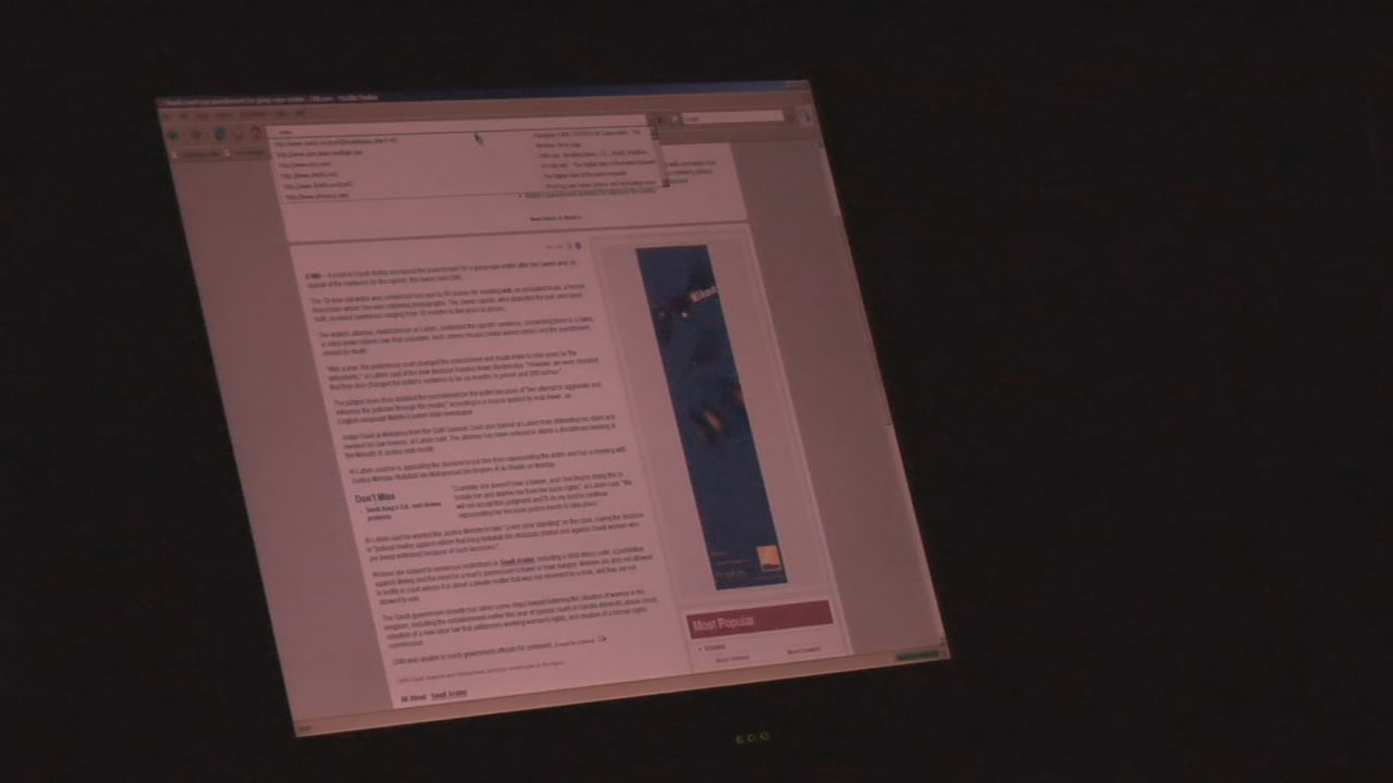

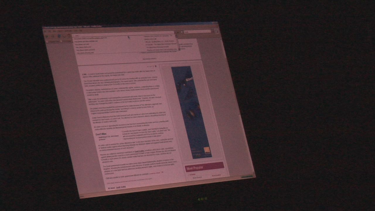

Let's hope DVINFO.NET don't crash on me ...
3 Quicktime MOV files + 2 JPEG files here.
All the QT MOV files are in 2 sections - the first is the original clip, the second is what comes out of Neat Video filter in After Effects.
0dB - no gain applied ("L" setting)
6dB - 6dB ("M" setting on my camera)
12dB - 12dB ("H" setting on my camera)
The JPEG files are the stills taken from the 12dB section - the noisiest of the 3 clips. The first JPEG shows the original, the second shows the output from Neat Video.
The video are compressed using Sorenson Squeeze. I have lightened the clips so that the noise can be easily seen.
Only managed to upload the JPEG files ... the MOV files are 6MB each. I tried to upload one MOV file - it failed. Chris, please check the server for space first. Thanks.
Panasonic please respond...-still1118_00000.jpg   Panasonic please respond...-still1118_00001.jpg

Got it! Wow... that's really incredible! I don't see the blatant softening of the image that I've seen in other programs. Man, I wish they would hurry up and release the Mac version.
Bill Edmunds is offline   Reply With Quote
Old November 18th, 2007, 09:46 AM   #30
Location: Singapore, Rep of SINGAPORE
Posts: 749
You may now excuse me for saying this ... With this program "Neat Video" - I would say that the excessive noise HVX202 produces is now no longer a problem. It is controllable, as you have seen it first hand for yourself.
