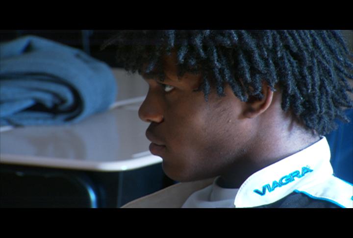

I'm getting some odd horizontal banding on a HDX900. It's intermittent, but I can see it in the viewfinder and it lays down to tape. It lasts a few frames, but modulates as it does. I've included an attached frame grab - look in the boy's hairline just below the top of the frame and at the very bottom of the frame on the left. The bands span the entire width.

The banding is so slight I almost didn't see it. I'm not sure it's an RF issue; assuming you're using a wireless mic system designed for pro-video I'd have a hard time with that explanation and, that would create a different type of visible noise than what I've seen from strong RF noise.
Jim Fast, who is the Panny repair rep in CA has at least one RF expert at his disposal; if you get the camera back and you can replicate the problem I'd have Jim's team take a look at it again. It would be important to know the exact environment surrounding the camera and, exactly what was connected to the camera during these moments when you see the banding.
To me, it's almost as if too much current is being drawn from the camera battery due to too many accessories attached at one time - that's what I've seen cause banding in a Varicam, but that was an extreme case and we knew how to fix it.
Replicate the problem (if possible) and make notes and send it to Jim.

Turns out I'm not crazy. There was a significant problem in the black levels at low light on this camera. One of the circuit boards was problematic. Panasonic had it for a few weeks, didn't find anything and shipped it back.
After that, A local camera guru in Boulder hooked it up to a waveform and found the problem in 15 minutes. We recorded it, and Panasonic has since fixed the problem... so they say. The unit is being shipped back now.
