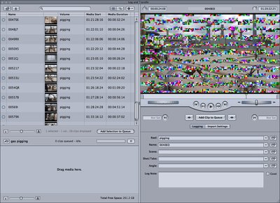

what the heck?
from today's video..
what the heck?-pixelied-glitch-log-capture.tiff
Gary Chavez is offline   Reply With Quote

Yep, that happens sometimes when you transfer on a Mac, especially if you are transferring to an external firewire hard disk and you haven't write-protected your P2 cards.
For years we've been recommending that people not just do a drag 'n' drop of the card contents, or to do a log & transfer from the cards directly; because this is the kind of thing that can happen. Instead, copy the footage to your hard disk using a data-verified copy, such as provided by P2CMS or by ShotPut Pro.

well, still getting glitches/pixelization. Not as often. Have transferred with write protected cards using both P2CM and P2 log pro. Do I have corrupted cards?

I remember Shane Ross saying that a dirty card connection could bring pixelation.
I have seen few pixels (but not that many) from a card which ı know has been several time pull off while recording. Cleaning the connection get rid of the problem. Colin.

Hey Gary have you played the footage back on the camera to see if there is a problem with it? If it is recorded incorrectly maybe you are seeing something from the head of the camera and not a problem in the datastream per se. Just a thought

ı am shy! As Daniel says, do a "play-back" in the camera first. We had the problem with just one card, it was easy tolin.
Play the footage back in-camera. If there's no corruption (which I pretty much absolutely guarantee you, there won't be) then there's nothing wrong with the cards.
Be sure you're doing a data-verified copy, where the program copies the files over, then reads them back and compares them to the cards. I am almost certain the corruption is occurring when you're copying the data to the Mac.

I definitely have heard of corruption issues when finder-copying to Mac. That is why I strongly recommend ShotPut Pro which will copy as well as verify.

While this won't work for every shooting situation because of time constraints, don't forget about using HOST mode to transfer the P2 card contents over to a HDD directly. (read up on this in the manual and Barry's HVX book).
In HOST mode you're simply using the camera as the HDD controller and transferring directly from camera to HDD with no software or intermediary device in between. Then just connect that same drive to your system for copy/importing into your NLE of choice. All you need is an external FW hard-disk with it's own power supply (we always use inverters in the field from a car cig-iighter socket) and a FW cable. That's it. Every P2 camera made from the HVX200 all the way up to the HPX3000 has this capability.
Keep in mind this isn't *shooting* to the HDD, it's just data transfer from P2 cards to drive.
