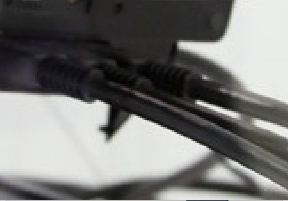

I just zoomed up a better pix of the JVC 4K2K camcorder.
There are only three cables that plug into what looks like a pull-down panel.
Two of the cables seem the same, while the other is different.
I guess the two that look alike are HDMI 1.4 that each carry half the pixels.
I assume JVC realized that there would be no receivers that can deal with a pair of HDMI inputs and so have a stereo audio output which is the third cable.
What I don't understand is how the 8 MP will be compressed. From what I know, 3D recording will be done by MVD which doesn't require require encoding 2 channels. Only one channel + depth data. So I assume this can be encoded by the 2MP encoder on FalconBrid.
But, HOW can 8MP pixels be encoded by one 2MP H.264 encoder?
My thought is that the 8MP JPEG encoder on the chip creates a stream of ordinary Motion-JPEG at a data rate that can be recorded on cards -- whatever current cards can do.
