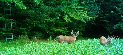

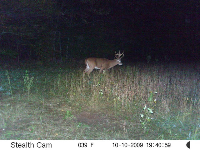

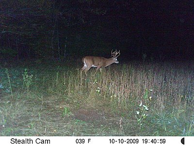

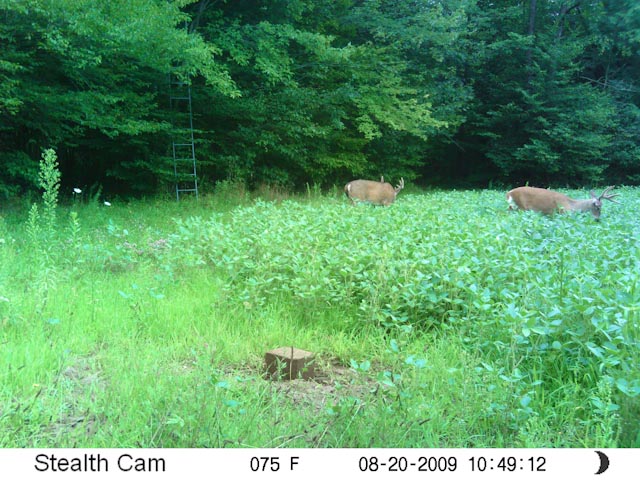

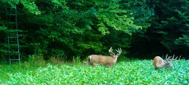

I have attached three still images from the same camera. The first one shows a daylight photo and the ladder you see is almost exactly 120 feet from the camera. The crop is from a few seconds later and the night photo will give you an idea of the flash range and at 120 feet the ladder is barely visible. On the bottom of the photos there is the date, time, temperature and moon phase which makes for an interesting timelapse in itself or you can crop it off if you don't want it to be seen in the final product.
