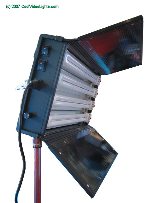

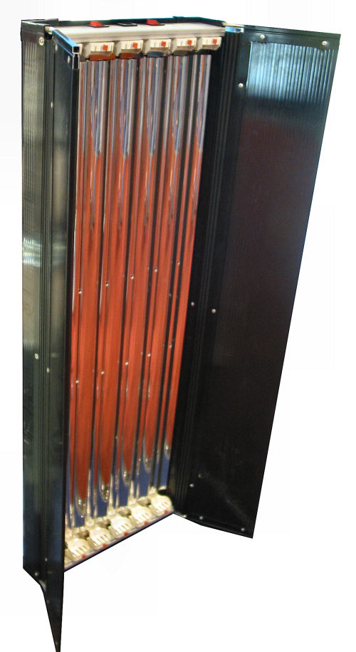

Here are pictures of the revised dimming version fixtures. Non-dimming will simply not have the dimming dial. The CL-255PMD and CL-455PMD. both of these were shot with the lolipop stem attached to a grip head, not the final stand adapter which adapts the lolipop stem to a 5/8" baby spud or a 1 1/8" junior female stand.
Holy Heat! Low Heat Lighting Solutions?-cl255pmdcm.jpg   Holy Heat! Low Heat Lighting Solutions?-cl455pmdcm.jpg

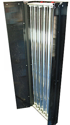

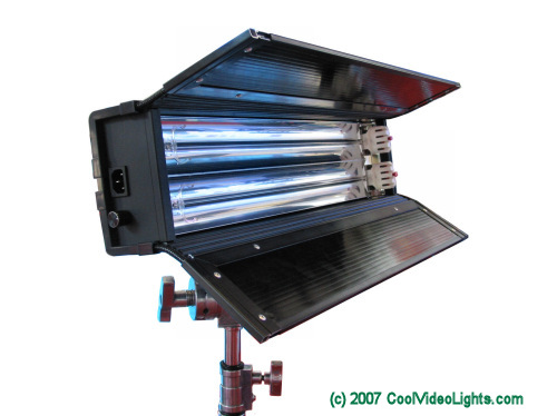

I also commissioned a 6 bulb fixture which they did, but the picture didn't turn out so great so I'll post that another time, but they also made me a 12 bulb fixture and a 6 bulb T12 fixture too--anticipating that I might want that in the future. Pictures below. On the T12, they put the ballasts inside the unit so they aren't removable. I told them I believe the removable ballast in a separate unit would be far more popular in the USA so if we sell that model we will re-engineer a separate 6 tube 75w ballast to accomodate it. While these are both very light, they will need a more hefty and larger aluminum lolipop instead of the nylon ball one on the smaller units. So a bit of re-engineering on that before we can call it a solution.
Holy Heat! Low Heat Lighting Solutions?-cl1255pcm.jpg   Holy Heat! Low Heat Lighting Solutions?-cl675pcm.jpg
