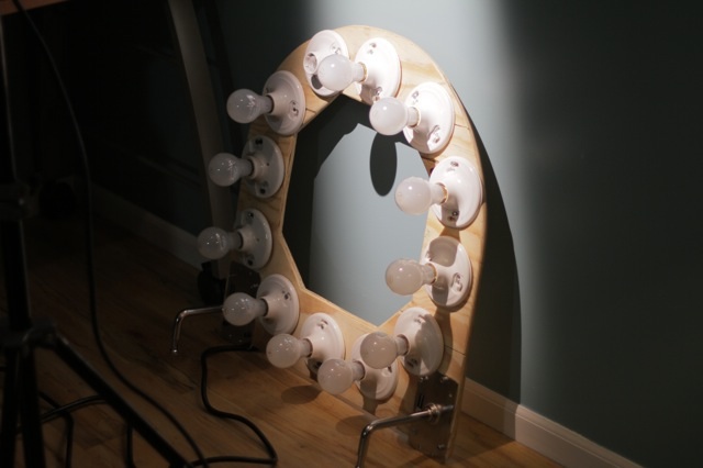

I found the DIY way to be effective. 2 small c-stands complete the rig.
I tried some CFLs but didn't like the results. I'm still looking for the best bulbs.

home made, less than $50
http://www.giroud.com/image1.jpg
