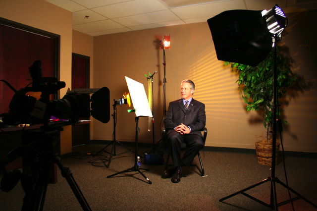

Again, this is just my experience, but one of the things I found was more often than not, my shoots were made difficult because I had TOO MUCH light, rather than not enough. Take the hairlight for example. In the past I'd have to cut down a 500w open faced light, and try to focus it on the right spot, sort of fighting two battles at once. The 150w works perfect. Just put a gel on, and its good to go. They also work great for fills, or spoting specific areas.
Yup, you'll want all the little things like gels, c47's, c-stands, sand bags, foam core (art stores sell foam core that is white on one side, black on the other). I bought a really neat gel holder that rolls up. I don't think I'm allowed to say where because they're not a sponsor of this site.
I'll try to post a pic of a lighting setup.

Its an XL2 and you pretty much nailed it.. yup, lets put on all the bells and whistles so that the client will be impressed. It was a shoot for a real estate company and they kept saying "you're professional, right?" so shoot day I brought out all the toys! :P
I see my kit as a very good foundation, so like Bill says, it wouldn't hurt to ad a separate soft box fixture. Not that my kit is leaving me wanting right now, but I could see it quickly becoming the "next thing" on my list. I just don't think you can have too many softboxes, they offer great light, especially for interviews. I did recently see a Yoga video that my wife got, where it was shot on a set, with really hard lighting, and looked great. Made sense because the hard light really helped define the muscles and body posture.
