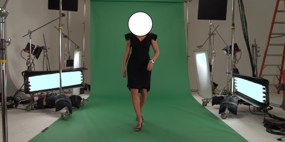

Lemme show you the lighting order from a greenscreen shoot I did 2 weeks ago at Smashbox Studios in West Hollywood:
1 X 9-lite Maxi brute Complete (medium globes)
2 X 5K Baby Complete
2 X 6K Spacelight Complete
2 X 1K Baby Baby Complete
2 X 650W Tweenie complete
2 X 4' X 4 Kinoflo complete (globed tungsten)
1 X 5K Variac
3 X beefy baby stand
1 X premie stand
1 X 6' X 6' frame (now quantity 1)
2 X 10' speedrail
2 X speedrail ears
2 X lollipop
1 X menace arm kit (remove entirely)
1 X 6' X 6' 1/2 silk
1 X 6' X6' Full silk
1 X 4' X 4' #216 gel frame
1 X 4' X 4' #250 gel frame
1 X 4' X 4' Opal frost gel frame
2 X 4' X 4' silk
6 X 4' X 4' black flag w/ flop
2 X 4' X 4' bead board bounce
2 X 2' X 3' (of each below)
black flag
double net
single net
silk
2 X 18" X 24" (remove all 18x24 flags entirely)
black flag
double net
single net
silk
1 X 1' X 3' cutter (w/ flop?)
3 X 3-riser combo stand
2 X set of combo wheels
3 X 2-riser combo
3 X hi roller stand
2 X low combo stand
20 X C-stand
3 X baby C-stand
2 X Platypus clamp
2 X cartellini clamp
2 X mafer clamp
6 X aircraft cables
(leaving out all distro)
This all to produce just:
It's not even a truck's worth!
