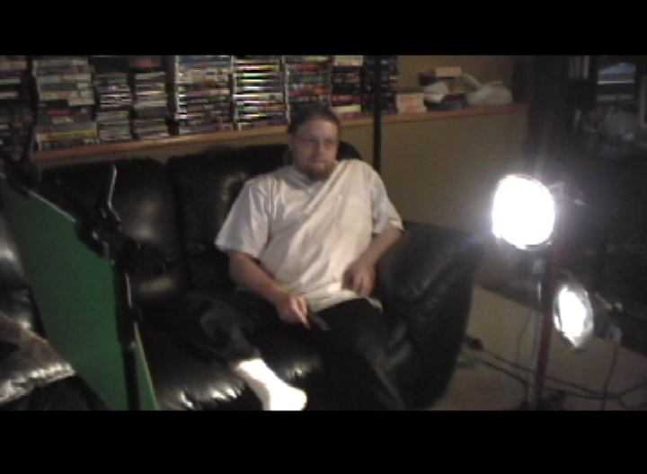

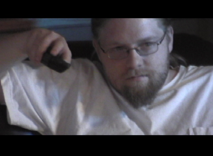

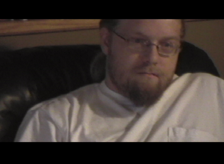

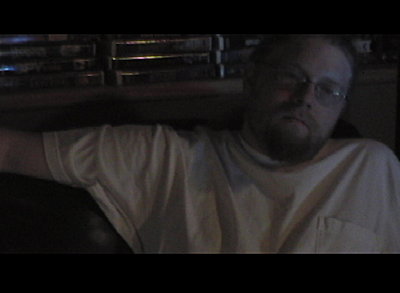

Freaky Charles, here's some test shots we did for our feature a few years ago...
For the TV flicker effect, we found that waving your hand too quickly looked stupid, but spreading your fingers out and moving your hand sporadically and medium speed up and down in front of a blue light looks like a tv screen with stuff happening on it... The way we figured it out was to shoot a day of horribly unconvincing footage, then turn on the tv and watch what it did on the wall. I actually watched the wall for an hour and noted how it reflected the TV (geek am i?)

The reality of a TV as a light source is several-fold: TV's are essentially daylight-balanced, so their light output is fairly blue especially compared to household practicals. A full-CTB light source, while accurate, may feel a bit "much" so I usually go with half-CTB. For the shot I posted above, I actually had a red, green and blue light bulb behind diffusion, each on a separate channel of a flicker box set to fairly slow variation.
In most instances , you want the light source to show up as a variation in intensity but not much movement (why the fingers in front of the fixture can look wrong). Essentially the TV itself becomes a light source, so it's best to recreate it with a source of similar size (like a small Chimera). Depending on the type of show being watched, whenever there is a cut you might see a shift in luminance (output) and possibly a bit of color shift as well. My best results have often been having a dimmer on the unit and having the chap on the knob make fast shifts to different places on the dial, with errratic timing (3 seconds--1 second--4 seconds etc). You set a high and a low point on the knob to keep your exposure in check.
