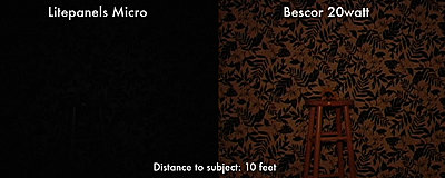

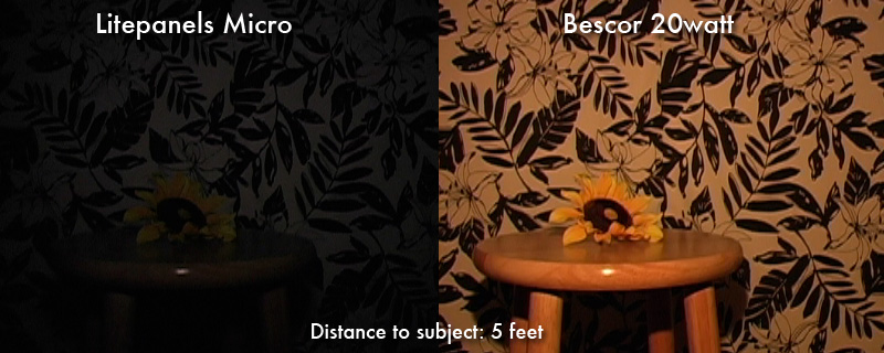

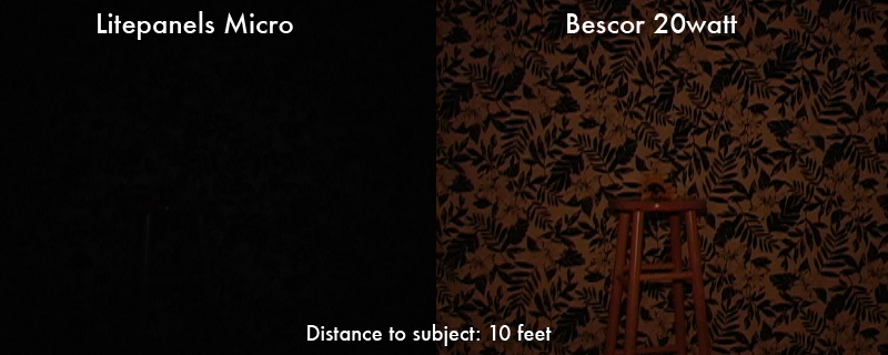

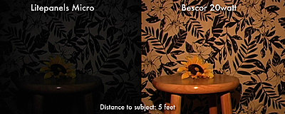

I've used my brand new Litepanels Micro at several weddings now, and each time I've felt like the light output was aenemic. So, I decided to do a straight up test between my brand new Litepanels Micro LED light and my 2-year-old Bescor tungsten light.
Below (attached to the post) are images from the tests. I with the Litepanels Micro on full intensity in a pitch black room 5 feet from the subject. I then tested my Bescor with a 20 watt bulb from the same distance. Then I moved the camera back to 10 feet from the subject and repeated the test. The shutterspeed, iris, gain and focus were all locked down on the camera to ensure that the results were perfectly unbiased. Both lights had diffusion filters in place, and the Litepanels Micro was using new (nonrechargeable) batteries.
As you can see, the Litepanels Micro was virtually unusable from 5 feet, while the 20 watt Bescor light provided a usable image. At 10 feet the LitePanels Micro was completely unusable, while the 20 watt Bescor unit still gave a usable image.
As you can imagine, I am VERY disappointed in the performance of my Litepanels Micro. The worst part is that I paid just under $100 for my Bescor light and just over $300 for my Litepanels Micro. For an extra $200 I should be getting a far superior light, but in fact I've received a far inferior light.
My $80 Bescor unit has 2 bulbs (currently 20watts each), and using just one of the bulbs the Bescor put out much more light than the Micro - plus I have the option to turn on the other bulb and go with a 40watt light if I want. My Bescor also has solid construction, whereas the Micro's construction is borderline laughable (the filter unit has a poor design, my battery compartment has a poor design, and the whole unit just feels cheap and breakable). The Micro touts dimmability, but with the low output I never see any need to dim the light. I always need it on full power just to get a little light. For what it's worth, as I turn the dimmer the light doesn't dim at first, then goes from full power to almost nothing very quickly, then hangs at virtually no light until the switch hits the 'off' position. The dimmable range is very, very small.
My opinion is that for $300 my Litepanels Micro has been a complete waste of money.

Holy Cow, Travis, that's a pretty ugly test! Any chance you can just return your Micro? You could claim it doesn't work as advertised, considering your description of the dimming 'capability.'

not to defend the lite but I also have the bescor and an AB that I ran tests with before I ever put my LP into play. My results were far different than yours. I ran the Bescor and AB with softboxes and 35W bulbs and the LP with the diffusion filter and 1/4CTO and the LP was a far more pleasing look than either the Bescor or AB. Not to mention the exposure was right where it was supposed to be. Perhaps you got a bad unit? In any case as I said many times before the construction leaves something to be desired but IMO the quality of the light it throws makes up for it. Last thought. 2 weeks ago on the job my camera took a tumble and hit the floor litepanel micro first. Not only did the camera survive but so di the light. It might be 'cheap construction but it held up. Believe me I've broken far more expensive gear doing less on the job.

Yeah, I'm hoping I just got a dud unit. I'll know more tomorrow. Don, I did see your screenshots earlier, which is one of the reasons I bought the unit in the first place. So you feel your LP matches your 35w Bescor in output? If that's the case, then this one MUST be a dud. My light light is probably worth about 3-5w.
