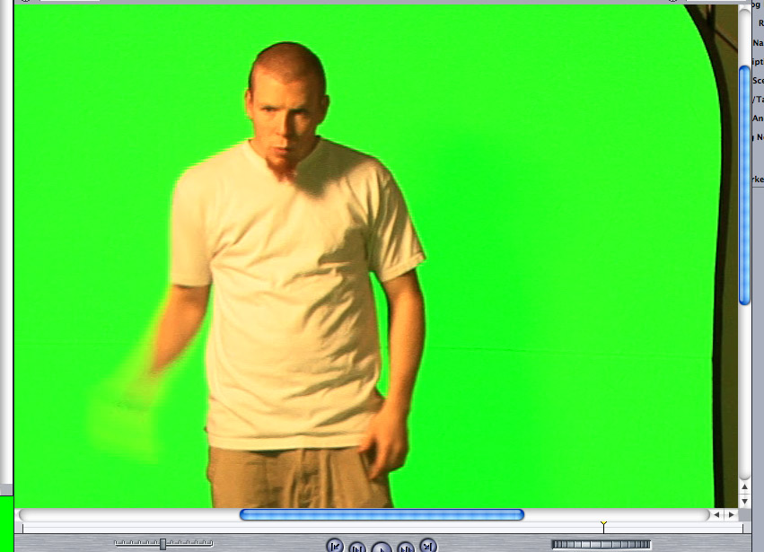

First time with Chroma Flex
I'm doing tests for a greenscreen shoot in a tight space (office). I'm using the Chromaflex setup and I'm getting an effect with moderate motion (hand waving) that is quite nasty. I added a picture below.
The yellow is bad enough, but the information is actually disappearing. Any idea on what I'm doing wrong here?

What camera are you using?
Use Progressive Scan if your camera has the ability
Make sure the Litering is 10' - 12' from the background.
White Balance
Turn the level with the controller down a bit, looks too high.
Use 1/60th sec if 30p or 1/48th sec if 24p
Properly expose your subject so they're not too bright
Use a softbox/soft light if possible
Guy Cochran
