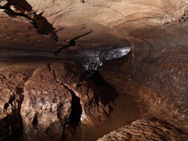

Posts: 378
When I've done cave photography before, I really want to use directional light so I can see shadows from the formations. This lets the audience know the shape of the object more.
I havn't done video in caves yet, but when I do I am going to probably bring two 150W HMI's One or two inverters along with one or two car batteries.
I've attached a photo to demonstrate some lighting.
This was using two flashes. One flash off to the left acting as what I would guess to be the key light, and one flash around the corner on the right. Having shadows in a cave is very good.

The type of effect that I was imagining for the documentary is similar to what Eric has posted. I was also thinking of possibly adding a gel or two too hyper amplify the effect of shadows crevices in dark corners.
