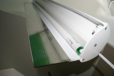

Seems like a good job to me. How'd you attach those barndoors, what are they and are they easily movable back and forth. I'm sure there are many out there that will want to know those details.

the barn doors are made of plastcore (4mm thick) and they can be interchanged, depending on what I'm lighting, I Made a mat black set for blocking light and a mirror set to reflect more light, if you look at the JPG I've added a small bolt as a pivot on the bottom and top, the kit on the picture is for background lighting. I've also added a metal braquet that I lock into place to guide the barndoors into place.
