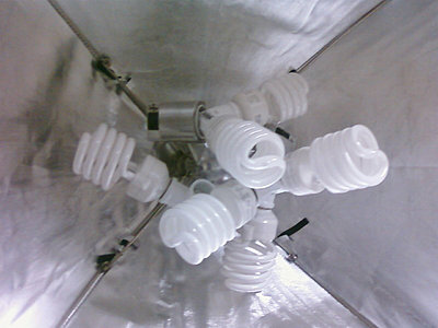

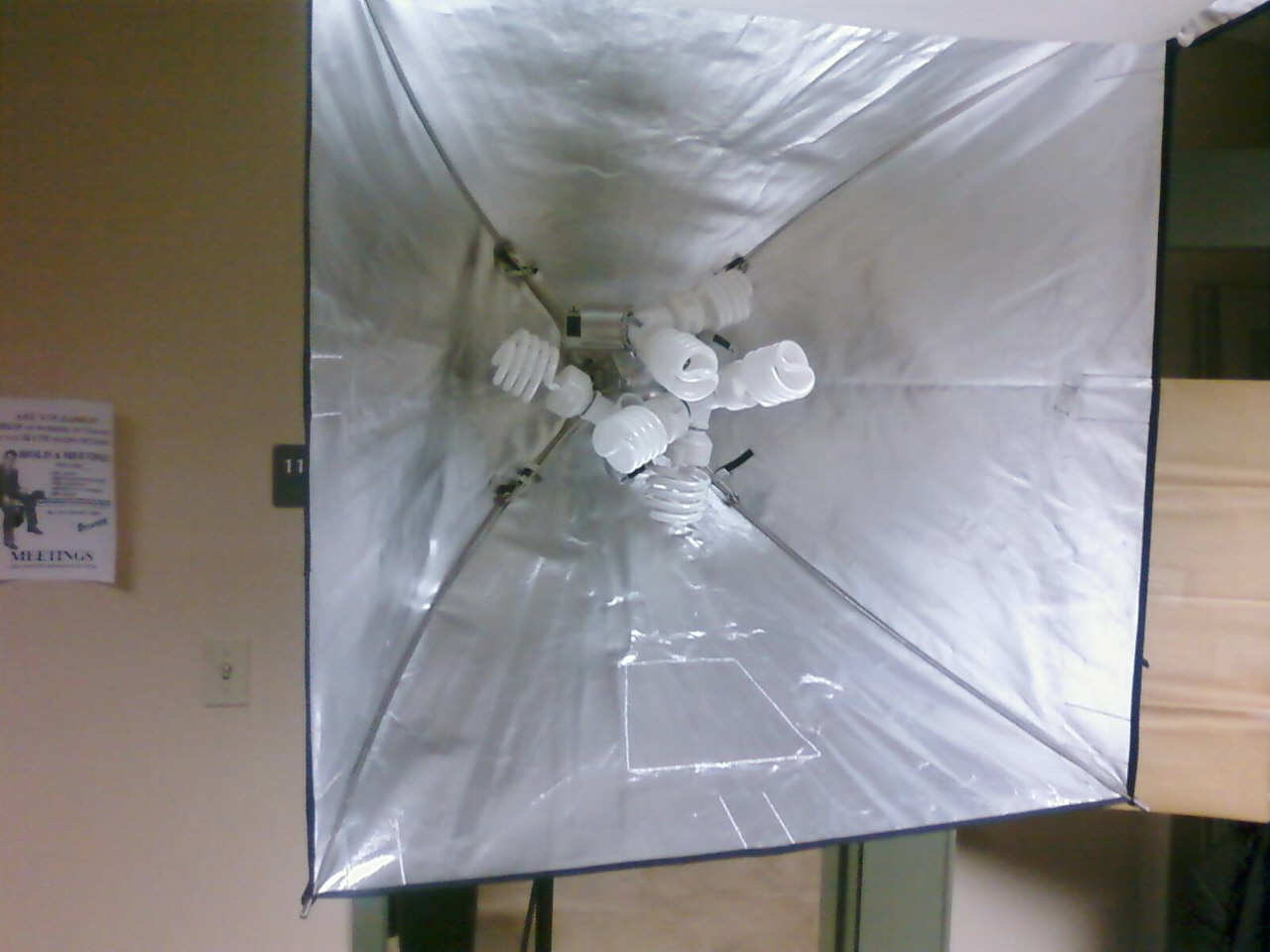

Posts: 4,100
I promised photos so...
RIFA 88 Photometrics-rifaconfig_wide.jpg   RIFA 88 Photometrics-rifaconfig_closeup.jpg

That's great, Perrone, thanks! How much of a hassle is it for you to break down and store the lights after a session? It seems like it's a little tight in there, and you'll have to unscrew each lightbulb and store them in what I think you said was a tupperware container afterwards.
Also, one question I have about flouro's is how to rate the amount of light they give off comparable to the 1000W tungsten that you'd usually keep in there for the EX88? Knowing the inverse-square law of lighting distances as well as the heat (or lack of heat) advantage of flouro's, is there any time that you instead back the light off a bit and use the tungsten 1000W bulb, or is the flouro set up you have just as bright in the end?
Ryan Mitchell is offline   Reply With Quote
Old January 7th, 2009, 09:50 AM   #12
Location: Tallahassee, FL
Posts: 4,100
I'm never in a hurry, so the extra 5 minutes is no big deal. In fact, these save me time over the time it would take the 1k lamp to cool off enough to fold up the Rifa.
