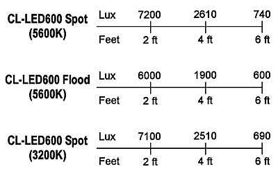

LED600 Specs
General Specifications
Dimensions: 10" x 10" x 3.25"
Weight: 3 lbs.
Construction: Powder coated (black) aluminum
LED Type: 5mm Round LEDs in 3200K or 5600K versions
LED Beam Angle: 40 degree for "spot" panel and 60 degree for "flood" panel
LED CRI:
- 5600K Spot: 80 CRI
- 5600K Flood: 82 CRI
- 3200K Spot: 85 CRI
- 3200K Flood: 85 CRI
Voltage Input: 10 VDC to 24 VDC
Current: 4 amps nominal at 12 VDC (48 watts)
Power Supply: 12VDC with IEC plug adapter and 4 pin female XLR DC output--includes
carabiner attachment to hang power supply on light stand. Universal voltage input 100VAC to
240VAC 50 / 60 hz
Battery Adaptation: Optional battery mount plates in AB (Anton Bauer) or V (Sony) types
Barndoors: Removable from slide in accessory holder
Stand Adapter: Angle adjustable baby stand adapter
Dimming: Yes viacontinuously adjustable dimmer dial
Bank Select: 5 bank select switches controlling LED column on/off with Master switch as well
Carrying Case: Black nylon padded case included
Operating Specifications
Optimal Temperature Range: 32ºF to 125ºF (0ºC to 51ºC)
Photometrics
All readings in Lux taken with light meter.
Doug Jensen EX3/Lighting Question-lux.jpg
Tom Daigon is offline   Reply With Quote
