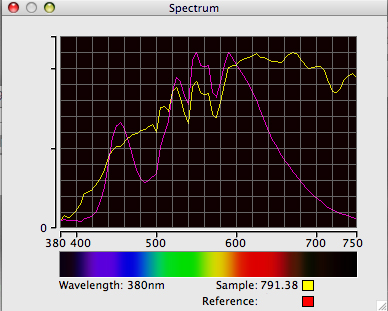

Here's a spectral analysis of daylight vs CoolLight 600 LED.
The yellow line is daylight.
The purple line is the CoolLight LED
Note that the energy level for the LED light starts to drop off rapidly after 600 nm, which is the deeper reds.
That might account for some of the skin tone problem, although I do use mine on occasion as a fill light for interviews in daylight situations.

What did you use to generate the chart in your post?
Chris Ficek is offline   Reply With Quote

Chris...
I used something called a Spectrocam. It's basic purpose is to profile printers but it can also analyze spectral qualities of light sources. At least it used to until the American version had to be "crippled" due to a pending patent infringement suit.
This is a fantastic graph! A few questions if you permit:

I don't have a Litepanel to test, so I can't provide a reading on that. Sorry.
As for filtering to improve the spectral falloff after 600 nm, that would be counterproductive.
To improve deficiencies in a light's spectral characteristics, you have to reduce the output of more energetic portions of the spectrum to be equalized with the the weaker portions of the spectrum.
As a result, overall output is reduced. In this case it would be dramatically reduced, with only a slight improvement in overall color rendition.
