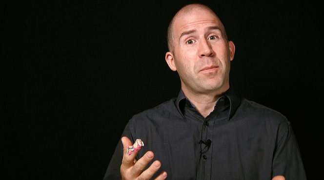

Recently I filmed an interview using a black background that I bought from backdrop alley.

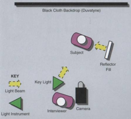

I used the light setup from a book I had recently read. See Lighting Setup image.

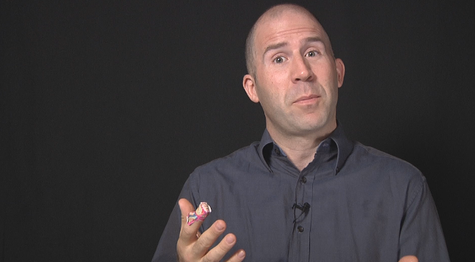

As you can see from the attached image labeled Noise.png, I had a lot of noise in the black backdrop. The camera I was using was the Panasonic HMC-150 at 1080-30p.
Fortunately, I have Magic Bullet and was able to improve the black backdrop as you can see from the Black_MagicBullet.png. However, I realize now the video seems too dark. But the client liked the look so that is good.
But in the future, I would like to shoot the interview without having to fix the background in post. Any suggestions on how to improve the black background effect without filming so much noise?
Any suggestions would be appreciated and if you know a better way to create this effect, I would love to hear what others are doing.

The noise in the black back drop could just be your black level setting in your camera. I'm not familiar with your camera so I don't know if that is adjustable. One thing you could do is ad a back light to help separate your subject from the back ground. It will give separation and should help out when you use MB.

You might try to control the light a little better, your "black" background showed up at about 20 IRE which puts it firmly in grey territory, your subjects shirt showed up at about 40 IRE. You need to get more separation between your actor and your background. You can try putting the lights up higher to control the background spill or use flags, even moving the subject further from the background and shooting long lens will help you. Once you get the background below 5 IRE you wont have as much trouble with noise.

The 150 is very susceptible to noise if the black level is not set. I'll try to find the page in the manual that describes how and how often to do it.

Lots of good advice. I did not adjust the black level. I had it on automatic settings.:(
I agree I should move the subject a bit further away. In hindsight, he was definitely too close which created a shadow behind him too.

You need to use manual exposure with a black background and set the exposure for the subject's face (or where ever you want the correct exposure to be).
Back lighting depend on your personal style, but it does give separation.
It helps to keep stray light off the black drap you're using as a background.

A backlight would be good to separate the subject from the background. I've been using a Comer 1800 LED for this lately as it allows dimming and is light so it's easy to boom.
