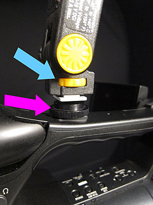

Epilog:
The LEDzilla light by Dedo is wonderfully designed and engineered. It's shoe attachment has a 1/4-20 socket and tightening nut built-in. That mechanism (blue arrow) nicely tightens to a 1/4-20 bolt. Borrowing a knurled 1/4-20 ring (purple arrow) from a spare shoe to 1/4-20 adapter, I am able to attach the LEDzilla with a very small (about 5/8 inch) 1/4-20 to 1/4-20 adapter.
How are you mounting things on 1/4-20 female camera mounts?-quarter20_attach.jpg

Les,
Sorry I didn't get back to you sooner; busy week. If you just unscrew the shoe adapter on the Ikan mount you are left with a 1/4" stud with tightening nut to secure it. The tightening nut is hard black plastic which is why I made a thin rubber washer to help cinch and secure it. If you try it I think it will give you more flexibility in light placement than what you have shown.
mb
