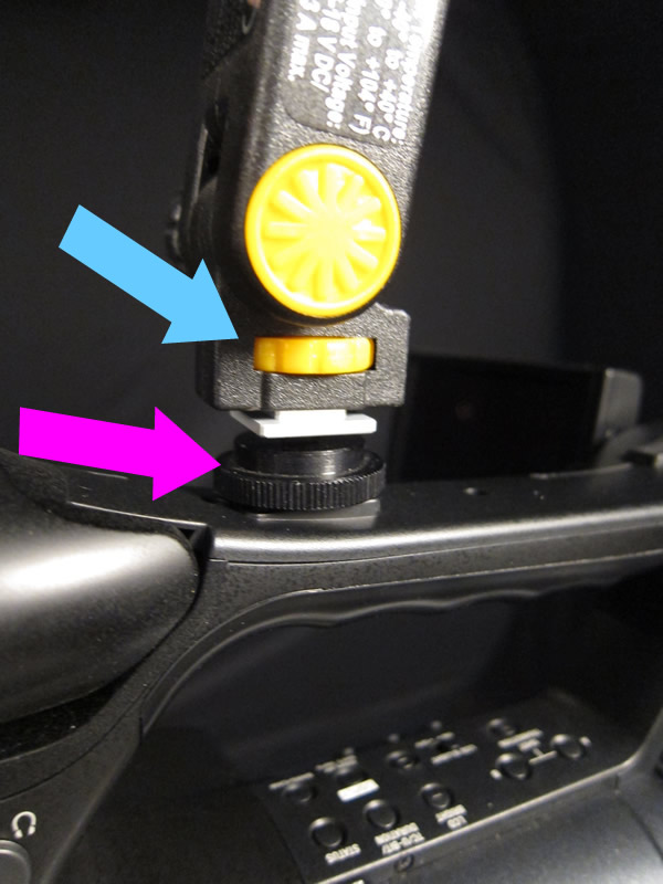

Just to add some finer design points I hadn't known when I bought it but noticed quickly:
Here it is with the 1/4-20 mount on my EX1R handle:
http://www.dvinfo.net/forum/attachme...r20_attach.jpg
1) The LEDzilla light by Dedo is wonderfully designed and engineered. It's shoe attachment has a 1/4-20 socket and tightening nut built-in. That mechanism (blue arrow) nicely tightens to a 1/4-20 bolt I made. Borrowing a knurled 1/4-20 ring (purple arrow) from a spare shoe to 1/4-20 adapter I had on hand, I am able to attach the LEDzilla with this very small (about 5/8 inch) DIY 1/4-20 to 1/4-20 adapter I made.
2) The whole light is made with precision. Especially the 4 light controls. They all move smoothly and fold absolutely flat.
3) There are tiny gel clips on the barn doors for gel-ing the light.
Other Data:
Using the meter in my EX1R, I see about a 10% loss in light output from the diffuser and 15% from the tungsten CTO.
The power cable from Dedo is right angle and threaded so it stays put.
