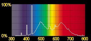

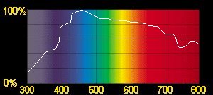

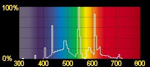

I took a look at your published test reports and I must say I wish all manufacturers were as transparent as you are.
For what it's worth, the data for the 55W daylight tubes reminds me of some old T8 tubes I used to put in my lights a decade ago, before fluorescent lighting became so popular (yes, I proudly consider myself as a precursor :-) ).
Those tubes were the Philips TLD 90 950 if I recall well (edit: confirmed, I just found the graph).
Philips too, at the time, tried to find a balance between lumens output and 'good enough' CRI, and I must say the graphs they published look almost identical to yours. So that's no surprise the resulting light output look similar on camera (which is, honestly speaking, greenish, IMHO...).
What I appreciate is your honesty in saying that you were actually looking for that 'balance'. At least people know what they're buying and it's then up to them to accept or not to trade lumens output for actual color rendition accuracy (which is different than published CRI)
That being said, sometimes later, Philips came up with an improved CRI version of those T8 tubes, called the Graphica, with a CRI of 98, with much better measured data. (see graph). Looking at the 'pro' designation and the published CRI, I was expecting stellar results. Unfortunately, these also had the same green output (again, to my eyes and cameras at the time...).
So, all that taken into consideration, and even though I understand your points about new standards being a pain to come up with and get adopted, I still stand by my point: CRI just isn't accurate enough a value to rate Fluos and leds output quality.
In the meantime, what we need from all manufacturers is graphs, just like the one you provided.
This way, if someone is in the market for, say, a daylight tube, then one can compare the manufacturers graph to the solar spectrum graph and draw conclusions from that.
But what manufacturers shouldn't do is wave terms like 'high CRI' and 'correlated color temperature' at the faces of people who actually work with these products everyday.
Note that I'm only talking about 'pro' products here, destined to color critical applications, like photo or video. Obviously, as you correctly said yourself, CRI is simple enough to understand a value that it still has its uses for consumer orientated fluos or led-based products.
Again, hats off to Cool Lights for actually publishing their test results. This is, IMHO, a step in the right direction and a proof of their seriousness and dedication to make things better in the video world :-)
EDIT: From left to right:
-Philips TL-D 90 950
-Philips TL-D 90 Graphica
-Solar Spectrum
Mikael Couderc is offline   Reply With Quote
