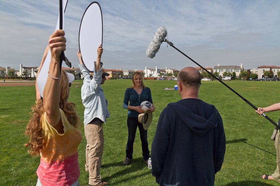

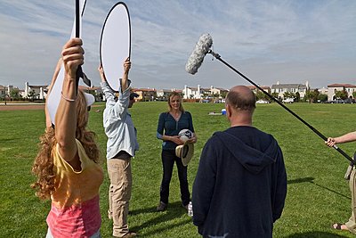

When you remove the reflective covers from those discs they aren't really made to bounce much light. They're more to be used as silks or diffusion. The picture below shows how we used two discs to silk the talent. This shot was an OTC, fairly tight on the female with just the shoulder and part of the head of the male in frame, so we didn't need a large silk to block the direct sun. Most of the discs also have a warm side (golden color) that reflects less light but will also change the color temp of the reflected light. Or better yet, just take a white foam board. Always have several white boards on set for bounce and several black boards for flags.
-Garrett

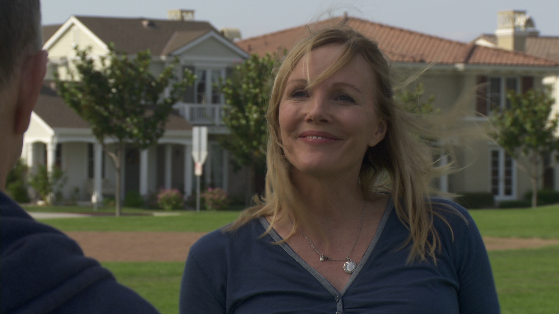

Here's a screen grab from the scene. Color grading not yet done.
-Garrett

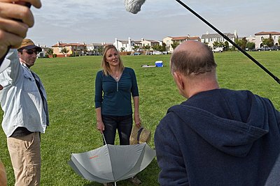

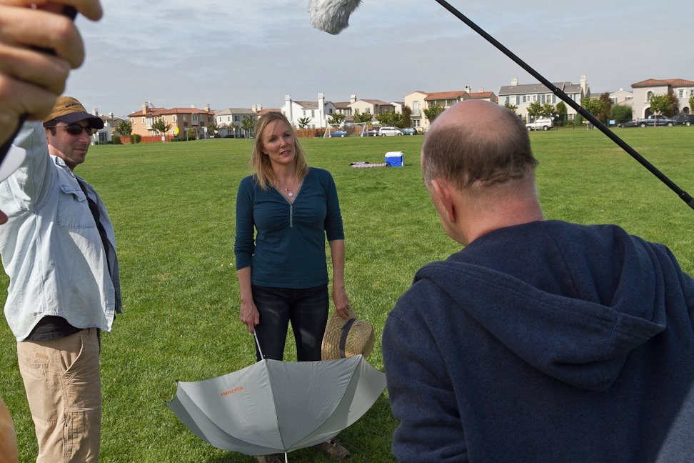

Also, moving the grip further away lessens the effect. The first photo in this post used that type of reflector and was about 15 feet from the talent.
http://www.dvinfo.net/forum/home-awa...ml#post1664817

Hey I recognize those folks Garrett :-) I should have gone on that shoot, might have learned me sumthin.

Les, that first still looks like what I want to achieve. Your idea of moving the reflector further away gives me the idea of simply using smaller reflectors, which should be more stable in the wind.

Bill is right about creating an unnaturally high amount of contract between your subject and the background when using some kind of silk. That and making your subject look too flat. We battled that and consciously did frame and set up the actors in this position to try to avoid that. It's not perfect as you can see the left side house is a little to bright and we just couldn't get the actresses eyes to pop without some kind of eye light. The problem here is to create the natural fall of the shadows, you have to reflect or light from high above. without any lights or equipment to get us up high enough we couldn't create a natural looking light source. So we had to go with this compromise. As you can see, she has very fair skin and direct sunlight was just creating a very unflattering look.
When we had her lit like the first example in Les' pictures, she look very hard and unattractive. And one thing I've learned, you never want your actresses to look unattractive especially on their close ups. I would have liked more shadows and character in her face but that was not going to fly.
