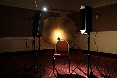

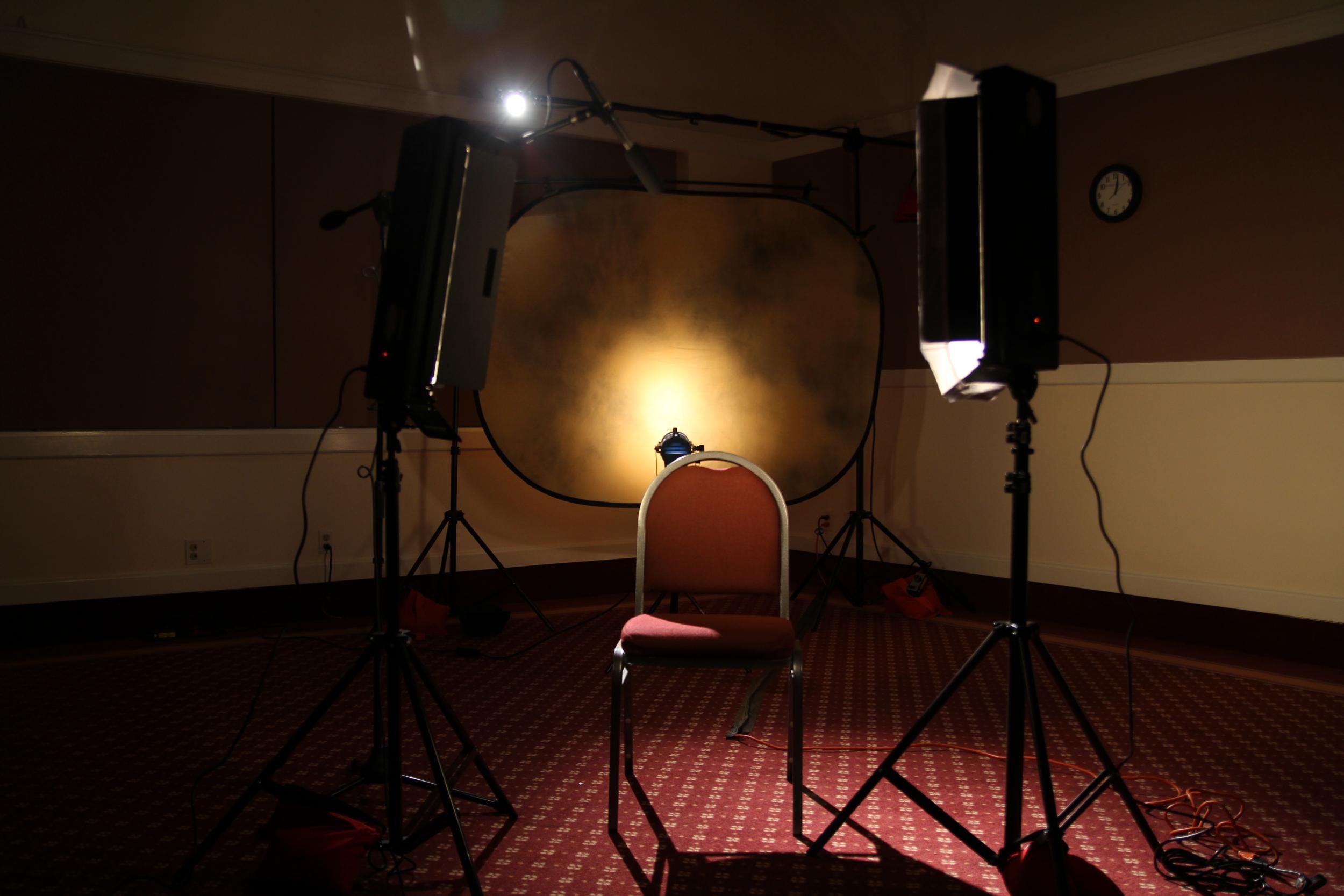

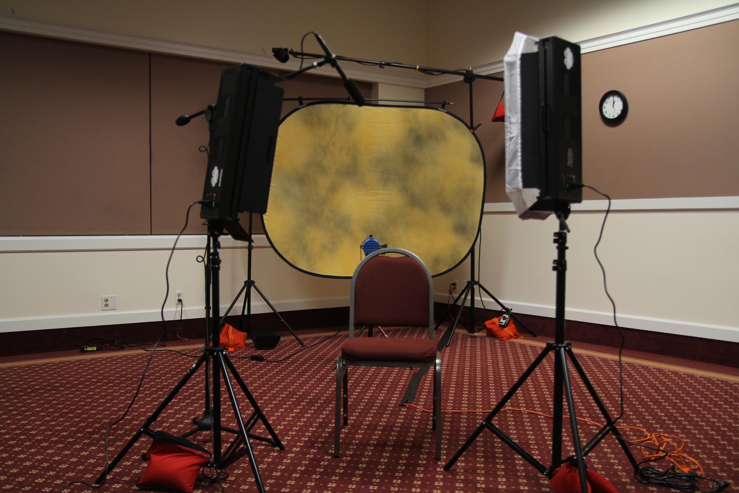

I would also go with a softbox and a reflector for fill (fewer lights, less heat). A white/silver reflector and it's distance to subject will allow you to control the contrast. Good quality c-stands will allow you to adjust the lights to minimize glare from glasses. In a pinch, have them remove their glasses when glare is severe.
I would further recommend shooting into the corner of the room, giving you more room on each side of the talent for the lights. Your hairlight will probably need more frequent adjustment. Keep it on a dimmer, have some blackwrap and diffusion handy and a chair nearby so you can adjust it quickly.
I do these kind of setups all the time and can share some recent setup photos if it helps.
to light talking head in small space-softbox vs fresnel-img_0653.jpg   to light talking head in small space-softbox vs fresnel-img_0654.jpg
oren-
great illustrative pix. thanks.
from the pix those look like two or four tube flos.
which company did you buy and your thoughts on their quality of light and sturdiness.
thanks in advance for adding to the conversation.
