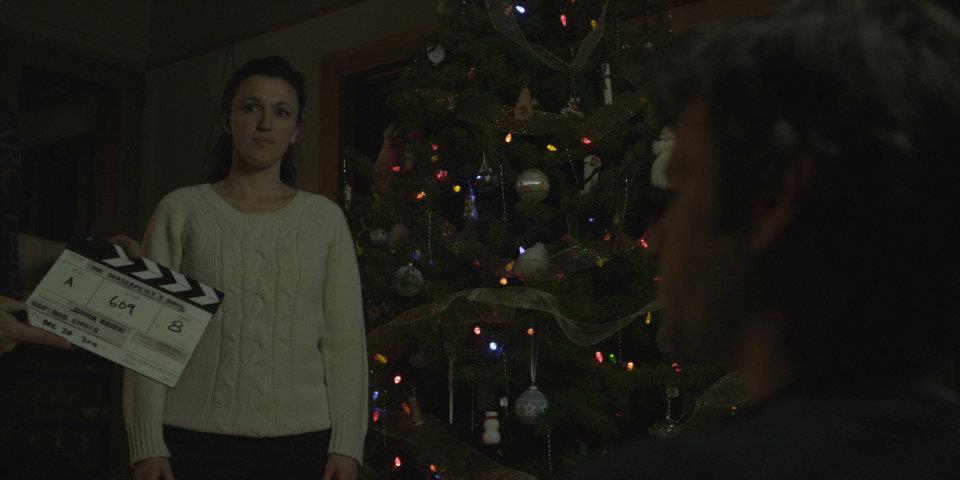

I'll have to track down the socket dimmer in Canada. I'm still working on a low budget feature here and yesterday we shot a few scenes while our veteran DP, and key grip were away and had limited gear for a scene. We are shooting on an Epic M at 800 ISO (exclusively), and at 5600k, which seems pretty crazy for an indoor night scene. We were on location in a waterfront home and trying not to be too intrusive. We had a daylight softbox, a couple of 250 watt peppers, a couple of c-stands, a single diffusion flag, and a christmas tree. We had much more stuff that we could have brought but...
Personally, for the last few years, I've been shooting one-man, run-n-gun stuff almost exclusively, and it's been years since I've shot with a crew. But in the last 2 years, I've started working on shorts and now this feature and another one next year, with another planned to follow that. And I really do enjoy the process. On this project, I'm principally pulling focus, but when you have a 4-person crew on a set, you end up doing a little of everything.
This is a 34mm two-shot and I found it to be a little flat and muddy for my taste. Looking at the frame grab, damn... it looks under-exposed. But I'm told that with the Epics R3D files, we can correct exposure, color temp, etc. I would have liked to light the background a little more. On the closeups we did a better job or rimming the left side of her face and creating separation.
I've got a few months to plan the next project, which I'll probably end up DP'ing, so I'm gleaning all the extra knowledge I can get. I'm storing a truckload worth of grip and lighting gear, in exchange for being able to use it when I need it. which is pretty cool.
