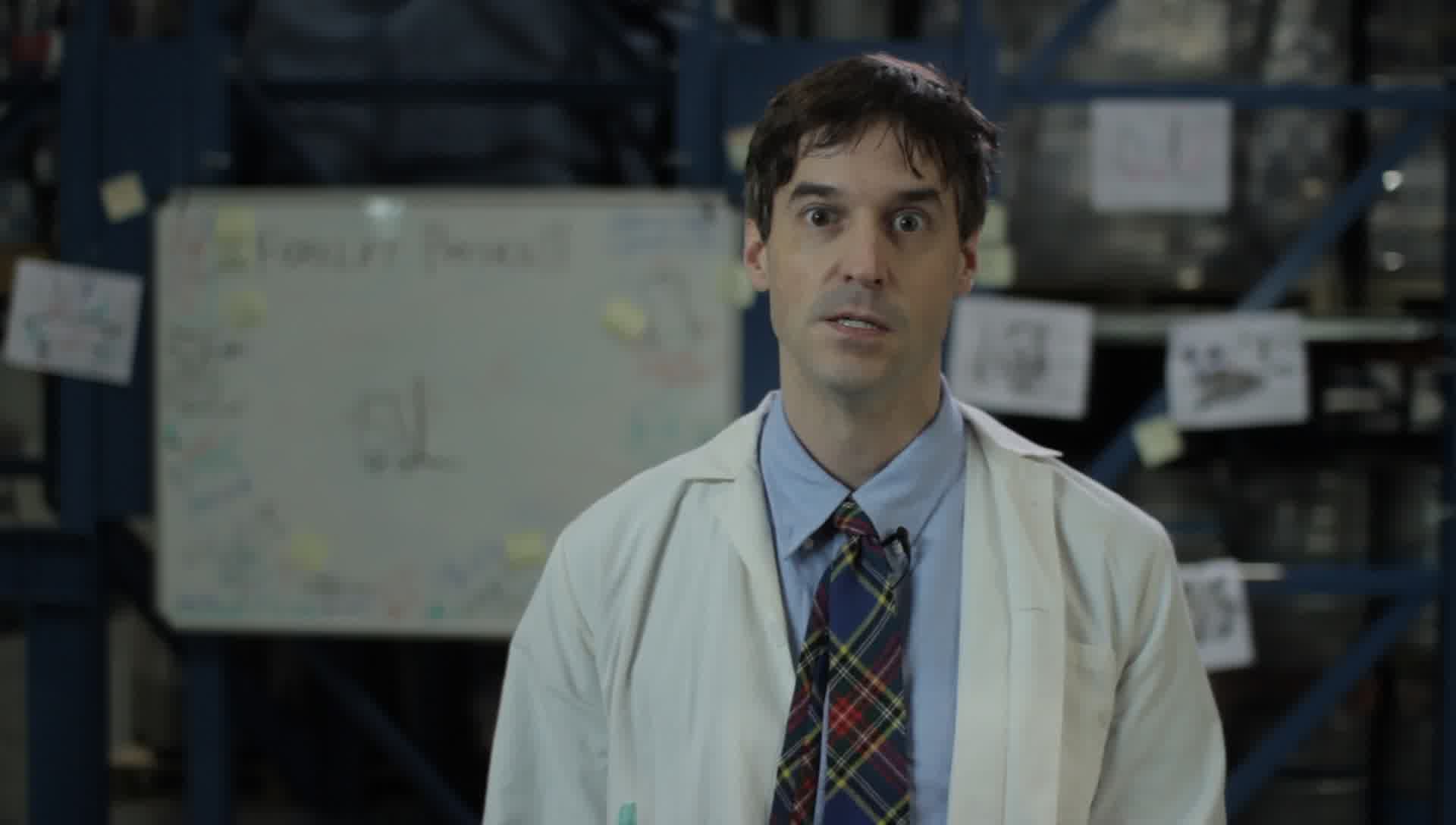

i've been running into issues shooting in a warehouse with my subjects looking like they have dark marks under their eyes, see screen shot.
im lighting with two 4 bank kinos on either side of the subject at head level, so plenty of light is getting through, but i can't see to figure out how to brighten up the area under the eyes. have also been placing a silk above the subject to soften any hard lighting coming from the metal halides above
is this is a problem for anyone else, what type of solutions have you tried?

If you place one of the lights beside the camera, it'll act as a fill. You could also use a reflector below to reflect light up.

Frontal lighting is pretty much the solution for this issue, which I have to manage all the time with actresses over a certain age (sometimes as "old" as 30...!). While there is probably a knee-jerk reaction that many have to lighting frontally because it seems flat and deviates from the classic three point lighting setup, it's a well-established glamour look...think ring light, for example.
Next time this happens, try setting one Kino just above the camera and one just below at half intensity (the top one with the stand just to the side of the lens to get it as centered as possible). Make sure to use diffusion like light grid or 250 on the unit. Good chance this will take care of the issue. If it starts to look a little too "sexy" or "studio", especially for a male subject, eliminate the backlight. If you find it really too flat, you can slide the units so that they are slightly to one side of center, still with perhaps 1/3 of their width on the other side of the lens--this will start to hint at modeling on the face but hopefully will still be filling the area under the eyes and to the side of the nose enough to avoid dark shadowing. If the subject can take it, you can raise the top Kino from just above the camera to as high as you like, within reason.
And as Brian indicates, a passive bounce set close to the person can work wonders, more so for bags and wrinkles than dark circles.
At some point, you can't do any more with the lighting and it comes down to a skilled makeup person to neutralize the dark circles.

I always run kinos vertically for this sort of shot. it in fact prevents the very problem you are talking about - darker eye sockets. I never use kinos horizontally because its too flat looking and the spill is a LOT harder to control. ditto soft boxes / chimeras.
another really simple fix is the obi light - a single bulb flow or LED mounted on camera maybe a 1/2 - 1 stop under the key. just enough to hit the face and get good skin tones w/o looking too lit or frontal.

I've had my eye on the catchlights in the eyes of actors in hollywood movies. I've often noticed only a single catchlight towards the bottom of their eyeball, indicating that the only frontal light was below the camera.
I think that because under-camera lighting looks so bad when it's the only light, we typically avoid it. But using under-camera light for fill only is a good tool to have in your belt.

It's entirely possible to illuminate an actor to exposure without a catch appearing in the eyes--it just requires a very large, uniform soft source. Ambient daylight in a room is a good example of this. Bounce cards (or "pizza boxes"--2x2 beadboard bounces handheld under an actor for fill) tend to not show up in the eyes, while a hotter, defined light source will.
