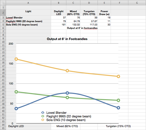

Thank you Arthur. I didn't realize but the approach of two sets of LEDs changes the brightness as you bring one set up or down. Did you notice any effects from the multiple light sources of the Blender LED array vs the traditional single light source?
I see with the Blender that by definition, you only get half the total 76 footcandle output at 6 feet , 39fc at Tungsten and 37fc at Daylight. And there is no beam adjustment with it. According to Lowel, the Blender draws about 18w when both sets are on.
In contrast, the output of the Paglight at 22 degree beam, 6' and 11w draw is 78fc Daylight. Then the output drops as you get to Tungsten.
Similarly, Sola ENG at 10 degree beam, 6' and 30w draw is 161fc daylight and drops.
It's impossible to compare without full data but from just these numbers, the Sola has 2x the punch but is 3x the draw vs the Paglight. But assuming 83% transmission for 1/4 CTO and 73% for 1/2 CTO, the Blender develops a little more punch in the middle as the two sets of LEDs combine versus the Paglight which only gets dimmer. I don't have data for a 22 degree beam on the Sola but I plotted it out (attached) just to see relative to the others.
The Sola and the Blender seem about the same size but the Sola is significantly lighter. I can't find the dimensions of the Paglight but it seems smaller. If anyone has data or experience with these lights, I'm interested in hearing it.

The 3 different units have unique features of their own. If one must decide on a light based soley on their fc rating, then let the brightest one win. Brightness comparison should be at same color temperature, same beam angle and same distance. Coming up with a true brightness comparison chart based on published specs is only a rough guideline and actual fc/lux/lumen figures are only obtained from a side to side test with a lightmeter and measurements taken also at center and edge of projected beam. Problem is that we are led to trust the photometric data given to us by the makers and often that data is overrated. Many do not know what lux and footcandles and lumens are but are used to F stops and asa with shutter speed terminology. An EV (equivalent number) at a standard distance may be all that is required as long as the color temperature is mentiond as well to keep all things equal. How about having all 3 units, each on a tripod, each projecting a same size surface area ( can be accomplished by moving closer or farther from the wall), each with the same color temperature and each set at full brightness AT THAT COLOR TEMPERATURE. Then take incident meter readings at a standard 400ASA and measure center, corner and edges as well as supplying a photo of the beam along with that data. Now that would, for example, look like this:

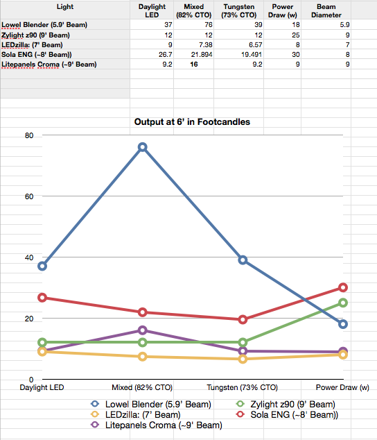

I've continued to compare portable LED lights and normalized the data so each fixture is at roughly the same beam spread at 6'. I also added power draw on the line graph. Normalizing for the beam size at 6' brings the Sola down in brightness quite a bit. EDIT: See note below about Blender
The shape of the LitePanels Croma and Lowel Blender lines show how brightness increases between Tungsten and Day color temperatures so the shape of the plot goes up in the middle. Whereas the Zylight is an RGB light, it's brightness is flat across all temperatures and the Sola and LEDzilla drop down as you go from native daylight to tungsten.

UPDATE: I missread the Lowel Blender photometrics. It's beam at 6' is less than 4' in diameter so it's unfair to compare it with the others which have a wider beam at that distance.
Anyone compared a Lowel Blender LED vs Sola 3 or Paglight 9965?-screen-shot-2012-04-06-7.10.06-pm.png
Last edited by Les Wilson; April 7th, 2012 at 04:34 AM. Reason: Found error in the data.
