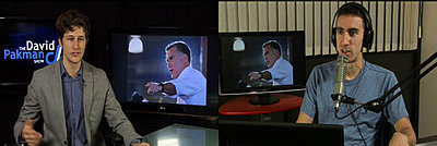

I've attached a still from today's show, comparing camera 1 and camera 2 after numerous adjustments to the lighting and the proc amp controls on our video switcher (Tricaster Pro). How does the balance look between the two cameras? Any other observations?
Just a note on Camera 2 on the right, we are waiting for an additional bulb to come in on his fill light, which will remove some of the shadow on his right cheek and shoulder.
