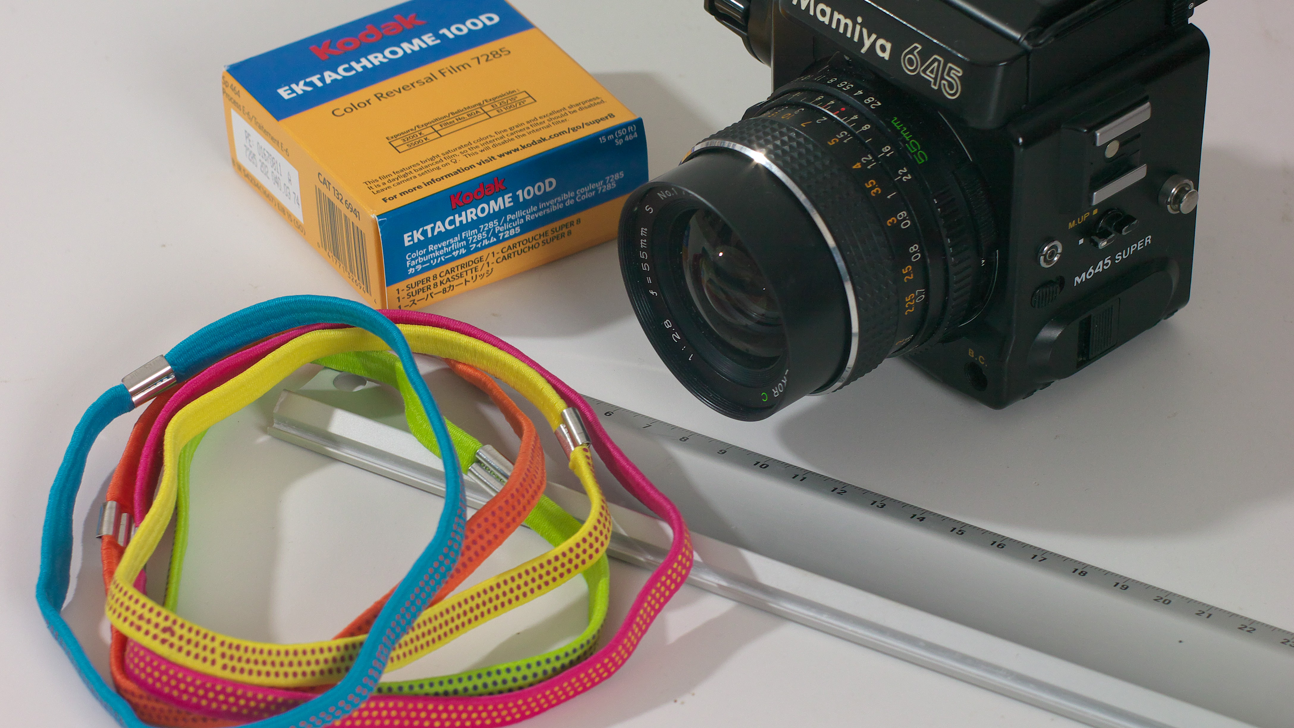

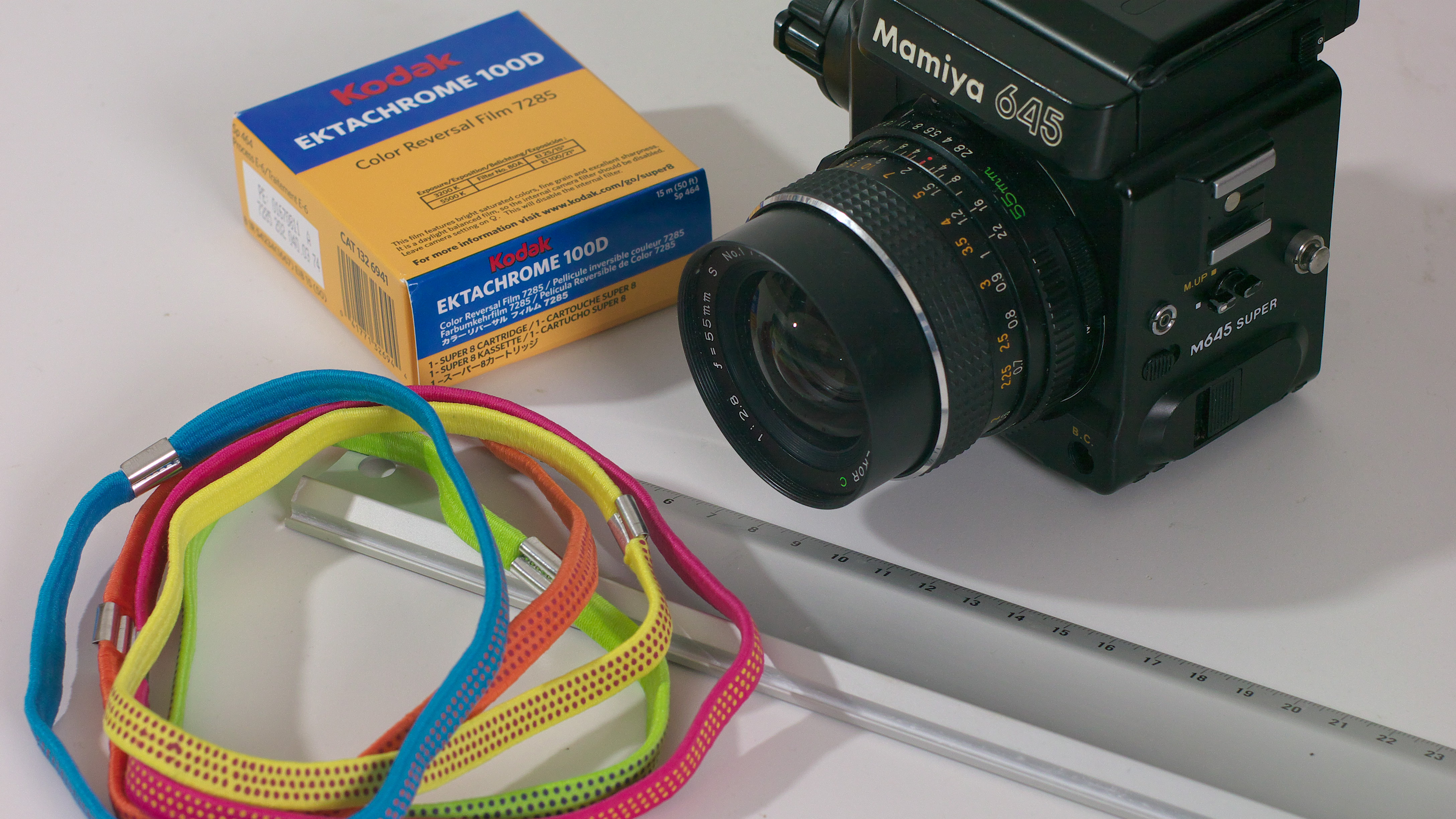

Just thought I'd update this for anybody who's interested. I shot this very rushed test on a GH1, which doesn't seem to suffer from the green cast problem as much as the GH2, in my experience. While the difference is very slight, I would say that the FL-D filter has helped to capture the colours more faithfully in this example. The blue on the Ektachrome box is quite a way off, in the shot without filter.
This was shot with a bare 5500k Fluo bulb and dull window light as the light sources. I did a quick custom WB on the foreground white in both cases. I'll probably shoot a few more tests before I'm really convinced, but it seems to me worth while having in the kit bag.
Edit to add, first shot on the left, is with FL-D filter
