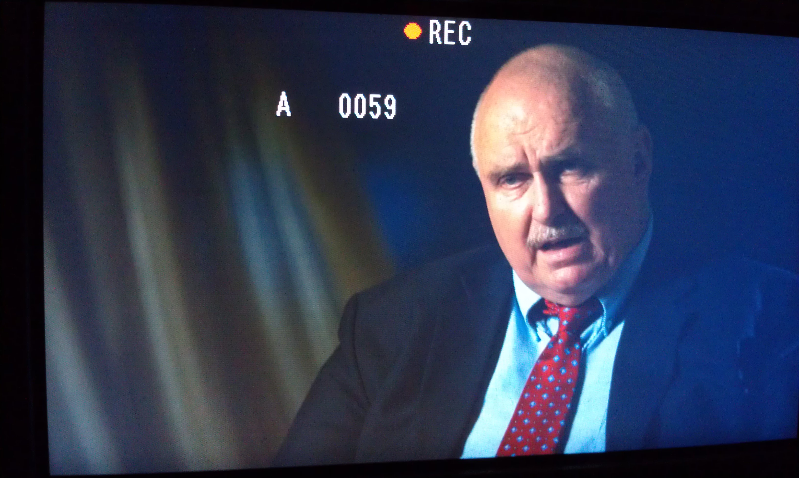

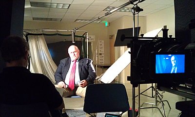

The reality of how you put together an interview setup is nothing like what you might expect it to be.
The setup you see in the attached crappy cellphone photos ( IMAG0164.jpg & IMAG0165.jpg) took about 1.5hrs to setup then another thirty min to tweak to the style sheet sent by the network. We were in a briefing room of a police station. This room had emergency lights we couldn't turn off so they had to be covered. This one was more complicated because it was being shot in multiple locations by different crews but they wanted it all to match. Way overkill for most needs but an example of how much work can go into some of these setup.

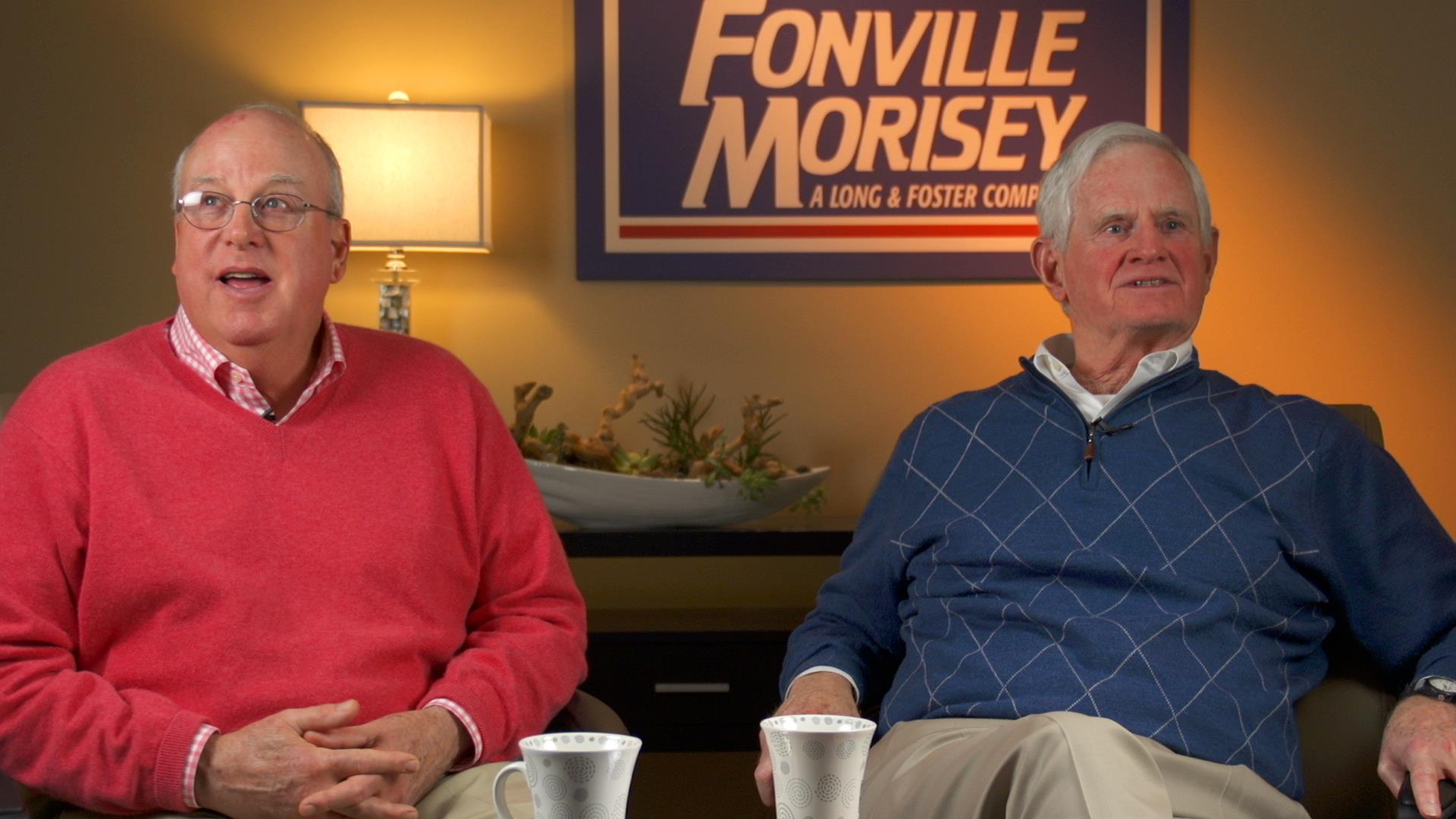

For a much simpler and more common setup using a conference room check out FV Interview.jpg. This is a setup for a corporate video. We used the length of the room to get some depth in the shot and put a table and the other things you see in the background there to add some interest. It took 5 lights for this setup (including the lamp on the table).
Lighting setup for the conference room shoot:
2 softlights for key/fill
1 hard light for light slash on wall (HMI with CTO gel)
1 light for highlight on plant
1 practical (lamp)
Not a light but important:
1 piece of black fabric on the ceiling to choke spill from the lights in the background.
Some of the basic ideas to incorporate in your setups where you can is to get the subjects away from walls. Distance between your subjects and the background is your friend. Put things in the background to add visual interest and/or context for the interview.
Lighting matters. There are tons of writings on the subject. Read as much of it as you can get your hands on.
Tricks for your kit - Get some white and black foam board from your local craft store or walmart. Have a couple of moving blankets and a background stand in your kit. Use them as positive and negative fill to make your lighting more interesting. This stuff can be had very cheaply and are very powerful tools to control the environment and make your interviews look professional. Its not always about adding light. Sometimes you need to take it away to get the shape you want.
Have fun and know its a journey. :)
