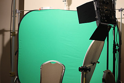

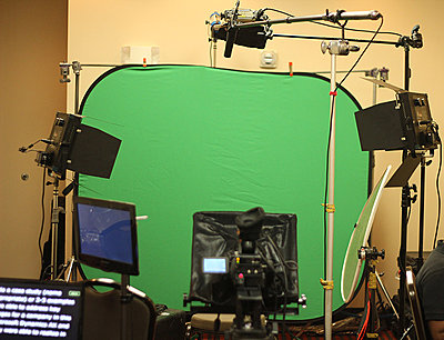

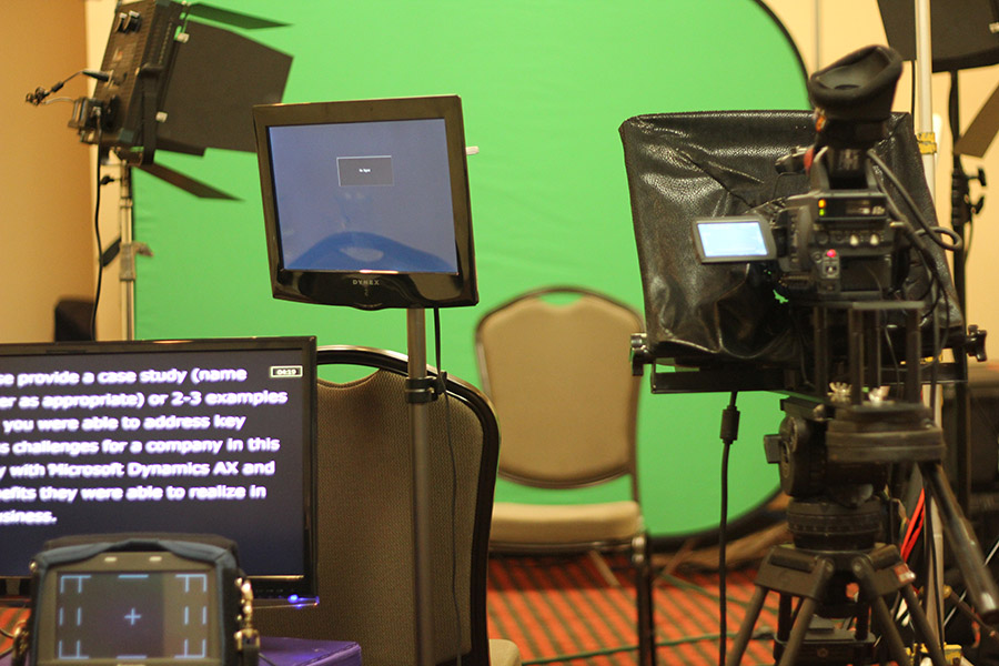

Hi Robert,
The best advice I could give you is to light separately and forget about 3 point lighting. Keep the talent away from the background and use your backlight wisely. This was a shot done on Tues and Wed for Microsoft. The talent was sitting in a chair about 5 to 6 feet from the screen. The talent is lit with 2 bi-color LED lights. The background was originally lit with 2 Arri 650's. We pulled them out and lit the entire screen with one tota light. There is one reflector to the left of the talent for warmth. We decided not to use the prompter and had the questions fed from the chair to the left of the camera. We preferred not to have the talent look directly into the camera. What you want is even light on the background and no spill. And as mentioned earlier light the talent separately. The background used here is a 7x9 Wescott. Sorry the pictures are poor but the lens was too long for the room.
Greenscreen Lightning question-green_1.jpg   Greenscreen Lightning question-green_2.jpg

Thanks Al:
Luckily we're not using the teleprompter. I'll do my best not to have the talent look at the camera, but based on the samples footage they forward over I may have too.
It's a relief to hear you and Doug say the same thing about lighting the subject and green screen separately. I just picked up an extra light kit set. There may not be enough room to use the Kino's so as a space saving room, had rented extra totas to light the green screen, and then use the rifa to light the subject.
As a precaution, had picked up a ton of constructor garbage bag and gaffer tape to block any light coming through the window. My hope is we can use another room without windows, but that's my contingency plan if we can't secure another window.
But the key I just have to remember in addition to get some practice time Is deep breaths, be calm, and stay in control of the shoot Sunday
so that the client does not get nervous of the shoot.

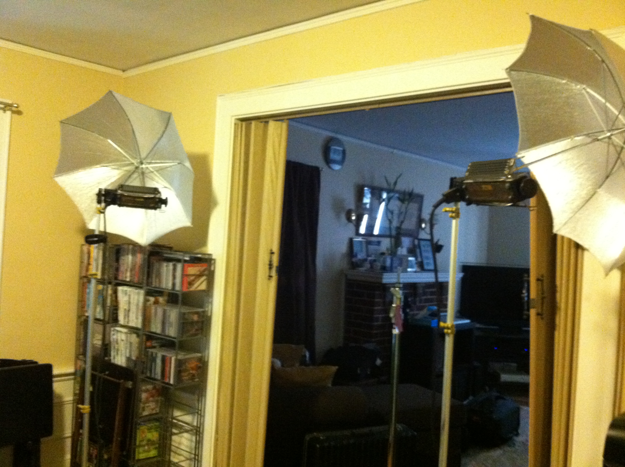

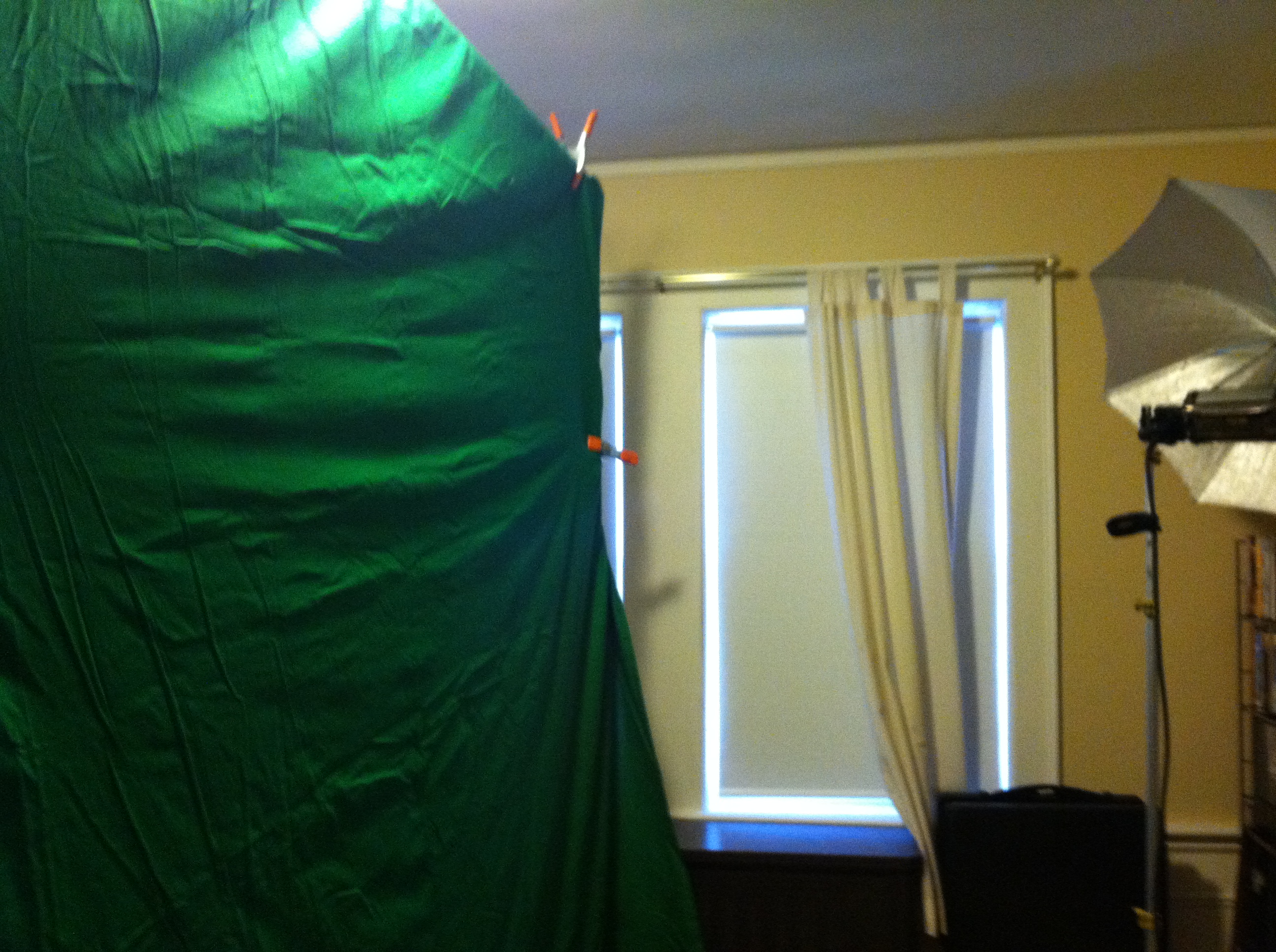

Hey everyone, just practicing my set up back home and lighting the green screen.
My question had to do with F-Stop
What's a good F-Stop range you've set in achieving even lighting on the green screen?
So far I've gone as low as 2.8 and as high as 3.6, depending on where I set my Totas.
As you can see in the photos my place is not too big I've hit often hit between 2.6 to 2.8, but
far as I know the room I'm shooting will be bigger.
(PS yes I know, I've got the green screen pulled tight to rid those wrinkles. :) )
Greenscreen Lightning question-117.jpg   Greenscreen Lightning question-118.jpg

Way to go Robert,
Sounds like a typical shoot. I remember shooting at a library at a boarding school in D.C. The scene was awful so I decided to do the old book case in the background scene. It was a little dark and I didn't have lighting. But there were these Tiffany lamps on very table. I was in luck. Until I found out the tables and the lamps were all bolted down.
Anyway, maybe you can create some kind of angle for your shoot rather then straight ahead. In the picture I posted, even though we had the prompter on the camera we had another monitor to the side that the talent could look at for cue.
I think you should do just fine. Although you should post some pictures of you on that table.LOL
