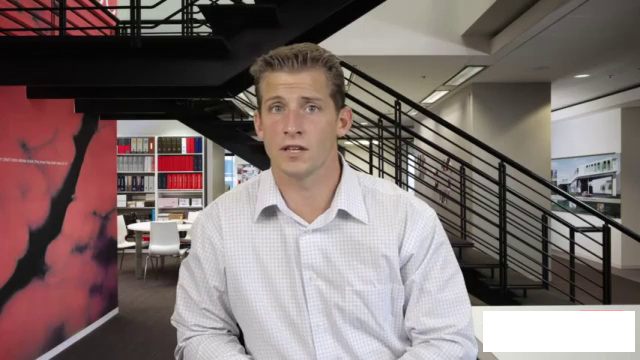

Thanks for the encouragement and feedback. Yes the client sent me samples of
other videos they had shot. I've attached a screen capture of the video of the background they used for their videos, you can see in the image they had the talent sitting down. Of the other videos that does not use green screen, they used an office. One that was shot, I was surprise to see the window in the background, that had a slight shimmer effect, Yikes! they did added various images, and text, so I imagine any shot they can't use they hid it well fading to an image or text.. That means the audio needs to be perfect as well, they must have used a boom mike or the shotgun from the camera, but I may stick with the wireless mic to be on the safe-side to not pick up any un-intended sound.
