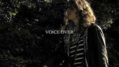

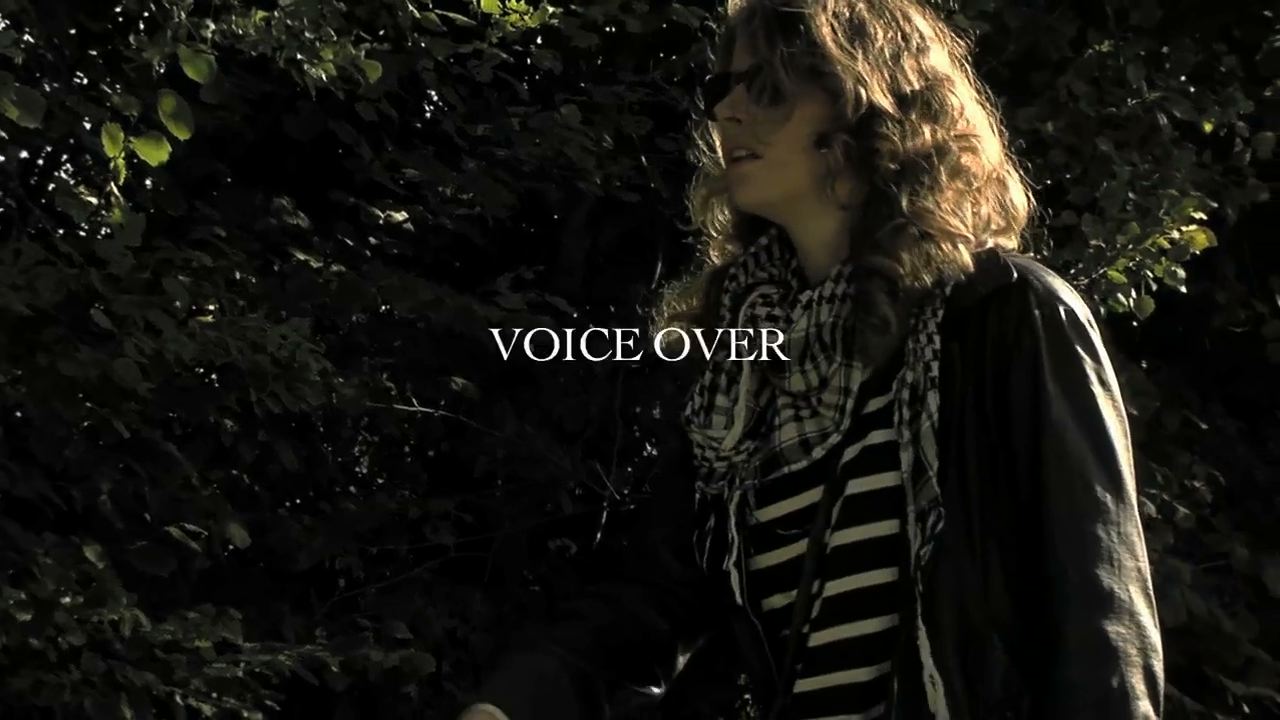

Hi & thank you for these very interesting replies .
Hopefully I have now uploaded the correct pictures.
in 'seq4-2' no attempt at correcting the green hue in the face was made as the sequence was destined for heavy grading. Without grading, the young woman looks ill and even the off-white stripes on the t shirt look odd. Cam setting was superwide.
for 'jeunefemme_lys...' I checked the shooting log which says a 4kw ?? was used with 1/2 CTO and sunlight was bounced in with a large mirror. The cam setting was superwide and it's not yet graded, yet the green hue on skin is minimal.
My original point is that it isn't possible to use settings or filters to dial the green hue out of the skin, without skewing the vegetation. I'm going to be in a forest which is really not accessible to trucks, so this precludes going Charles' way and adding light , as in 'jeunefemme_lys' .
Bill suggested using make-up to correct. That's an interesting idea which I'll definitely try out.
Other suggestions include some portable LED,s on or near the cam - that might still work for medium shots (but nothing wider) and would also provide an eyelight. Maybe CTO on the LED might also help. But matching the takes will be a real problem.
Another solution I've considered is gold or gold/silver bounce, but the light under the dense forest canopy may be too diffuse.
