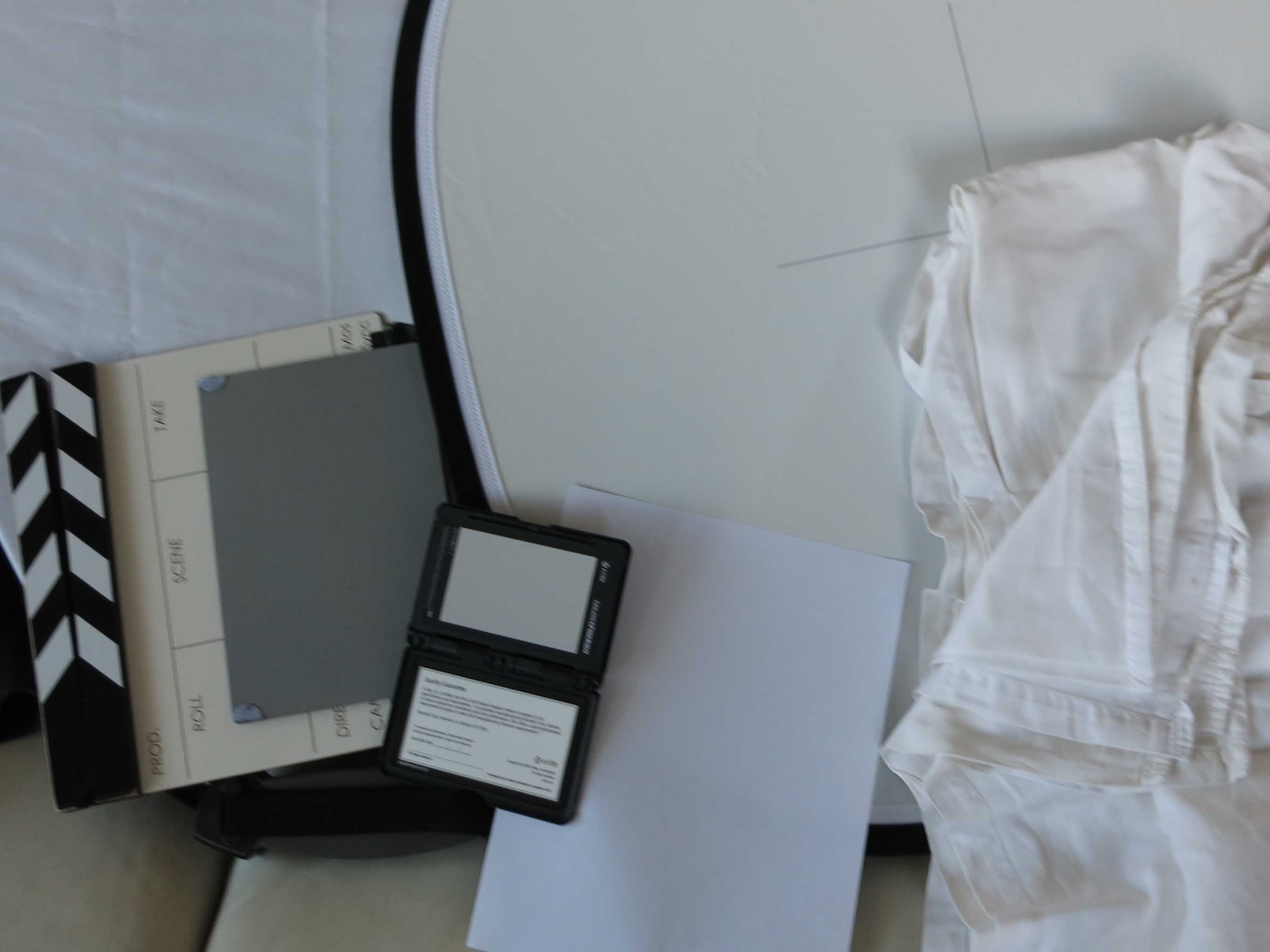

I thought I'd update this with a test picture that I took with all the white targets I have. Attached is a pic with:
Going clockwise from upper left:
Lastolite tri-flip white panel
Lastolite Ezybalance
An old "white" sheet
A sheet of laser printer paper
The Gretag MacBeth ColorChecker white panel (in top of black plastic frame)
RMI digital grey card on top of a cheapo clapper.
(on the bottom are the cushions of a white leather couch).
This photo was taken at daylight color balance setting on a Canon s110 camera, and color not adjusted in post.
I am glad that I got the Lastolite Ezybalance; it seems to be well calibrated to proper color balance and I am surprised how useful the cross target is for framing. However I'm not happy with the way that the Ezybalance doesn't tend to lay flat; it has a tendency to curve into a saddle configuration reflecting different colors from different directions on different corners.
