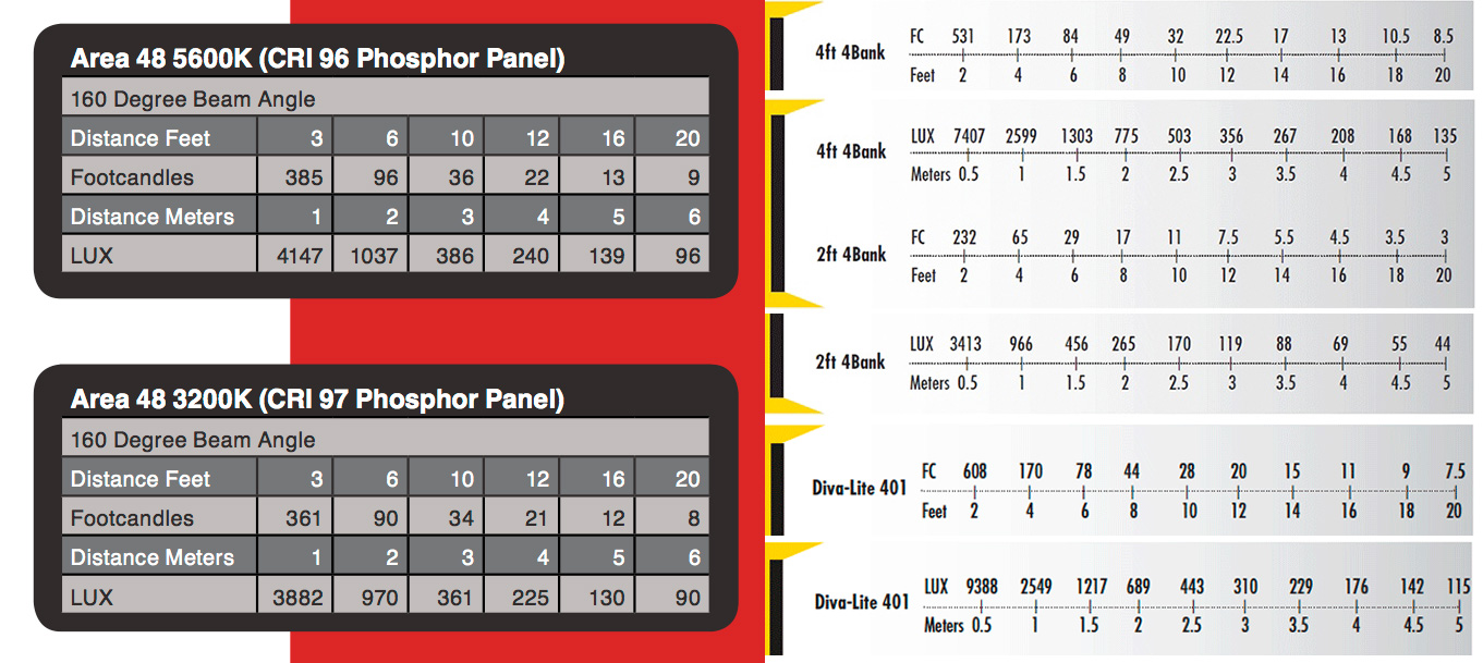

Hi Mark. Any photometric tests that indicate how many lux at 6ft. (2m.) the remote phosphor unit has at full brightness ?? The only thing I see is that it is a 1000W softbox equivalent, which is vague at best. I searched all over for the LUX rating and cannot find any true photometrics of it. If you have a lux meter, can you place it at 6 feet and get a measurement ? I greatly appreciate that.

Mark, I found the specs.

Hi Arthur, I'm going to run some more tests myself to compare and confirm the photometrics of the Area 48 against other softlights (the next time I have some kinos around) and I'll post them up here. Here's the official photometrics for the Area 48, the 2' and 4' 4-bank Kinos, and the 2' 4-bank Kino Diva.
So basically the Area 48 is giving you a little more output than either a 4' 4-bank Kino or a 2' 4-bank Kino Diva at up to 3m (actually at 6' it's practically double the output of the Kino Diva and Kino 4' 4-bank), and then pretty much levels out with them at greater distances.
The colour rendering and complete lack of colour-shift on dimming certainly goes a long way in the Area 48's favour (as does the fact you can just throw a battery on the back of it(!), but the fact that it's a physically smaller fixture does make the bare light a little 'harder' than the fluoros, you don't get quite as much wrap (though it's surprisingly close). I also suspect the Area 48's 5600k panel is actually a bit closer to 5000k than 5600k (it's a bit warmer than the 5600k tubes in the kinos).
I'll have to test this further, but I suspect the Area 48 will really shine when fired through larger sheets of really light diff (1/8 and 1/4 white) to provide a larger source.
