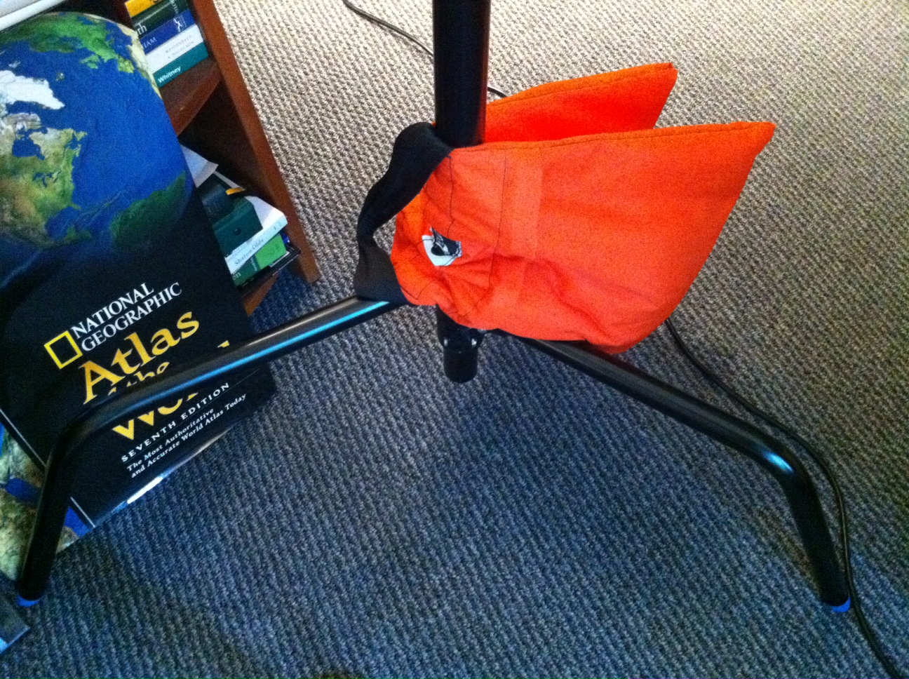

That's not how I do it. I put the longest leg under the load, then wrap the sandbag around the riser to put the weight opposite of the load. This way I only need the one sandbag, and it guarantees the bag doesn't touch the floor for all but the strangest bags.
Here's an example from a client's living room shoot:
Bruce has good technique.
