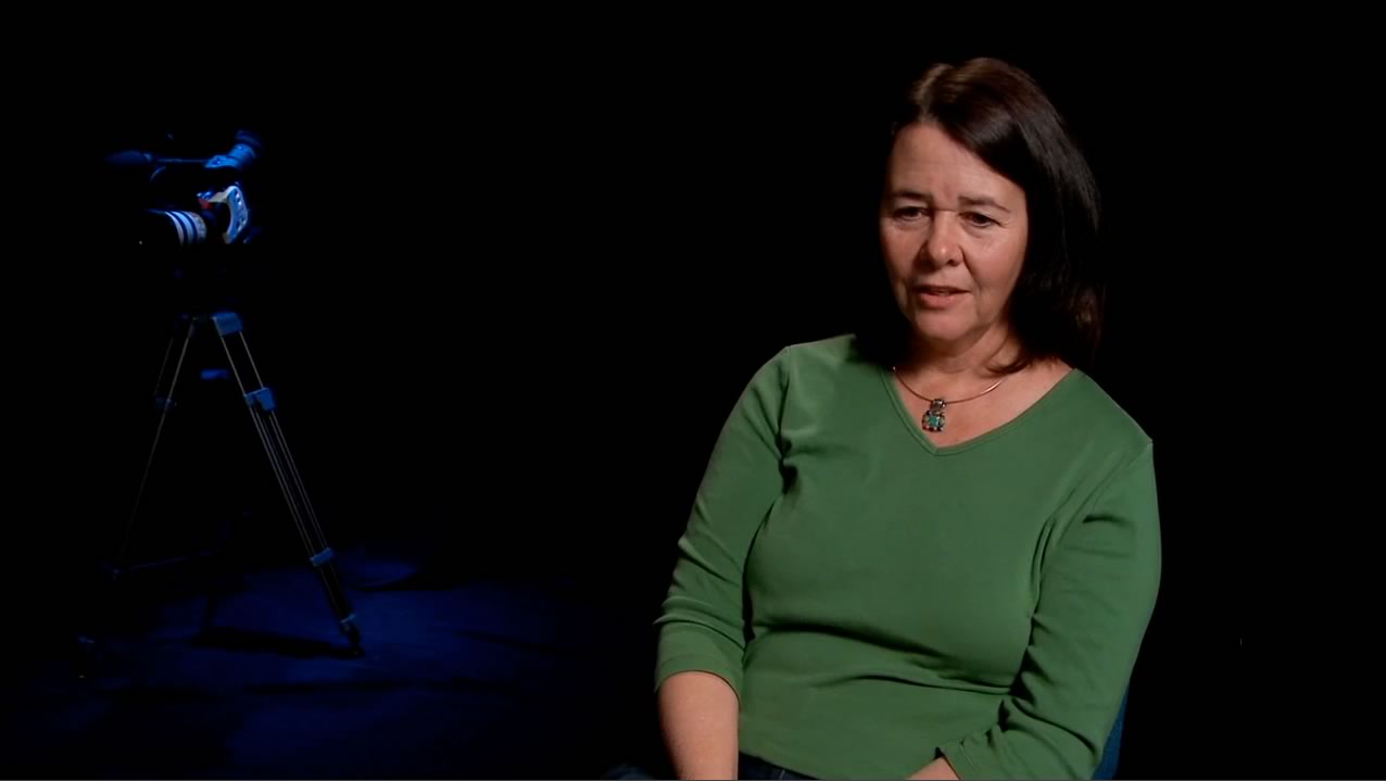

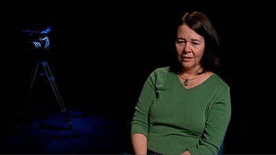

It's critical to control the spill from your lights. Unfortunately, LED arrays splatter light in all directions.
A dark room and distance between subject and backdrop improves things. I agree, a 4x4 is small for anything more than a shoulder shot if that.
If you are in a less than ideal situation, experimenting with your camera may help you find a color profile gamma setting that has hi contrast at the expense of dynamic range but ....
The backdrop is 6' away in this example.
