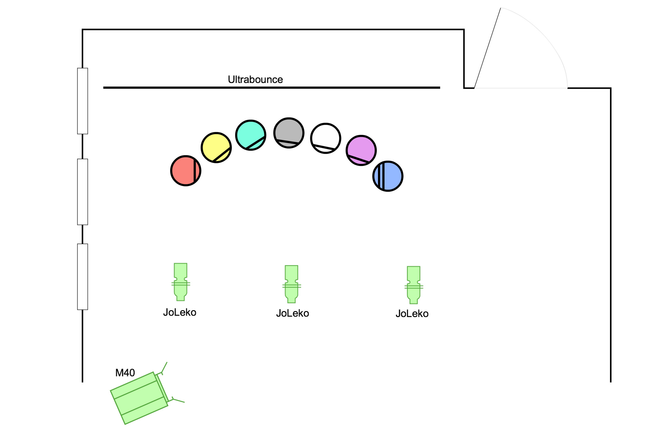

I'll play a little devil's advocate here. The key factor for why this wasn't a great idea was that Nathan described the room as ugly. A ceiling bounce will pick up the illumination overall so this is why it's a bad idea in this situation. However: in some circumstances, it can actually be a great thing. After many years of shunning it, I actually went through a little "ceiling bounce renaissance" a year or two ago under certain circumstances. Couple of examples below:
(light on the students is overhead fluorescents, some turned off for modeling--the light on the stage is a single ceiling bounce, about 8 feet in front of the stage).
(Once "Obama" starts shaking hands, everything is lit with a series of carefully placed ceiling bounces, all from floor stands behind camera)
Of course, those aren't interviews. But...given a big enough space where the light could fall off into the background, I could see a scenario where a ceiling bounce could actually be a great look. This would be for a particular style of interview, to be sure. Not a classic TV style talking head that is in the broadcast mold, this would be more naturalistic, maybe a little raw.
For something that is often thought of as "brute force" lighting, there are actually quite a few variables you can play with. A head pointing straight up at the ceiling creates a round source, but if you tip it forward, it will become oval. And if you walk it off to the side and then aim it perpendicular to the subject, it again becomes an oval but this time rotated as a wide source rather than a tall source (something like the difference between a 4ft 2bank Kino in vertical vs horizontal orientation). And finally, the proximity to the subject determines the toppiness of the source--the further away from subject, the more that toplight will start to resemble a soft key source on a floor stand.
An example of the side-raking ceiling bounce is in this one:
The existing fluorescents in the room were an oddball type and we saw out the windows, so I needed to relight the room with a daylight source. I needed plenty of room for the cameras to move around, and if I started putting sources that far back they would end up causing camera shadows for the close stuff. The M40 placed in the back of the room raked across the ceiling, making a wide soft source as detailed above that covered the entire width of the room. And to keep it from looking too sourcey, I added a series of JoLekos (Leko lenses with HMI backs) that were tightly focused onto a long swatch of ultrabounce clipped to a header on the wall behind the actors, which wrapped the light from the other side It was a bit of an experiment, but it eliminated the evenness of a classroom environment without any complicated rigging (see diagram below)
Sorry if this is divergent from the interview discussion. Really all I'm trying to do is provide a point of view that suggests that "ceiling bounce" isn't a dirty phrase, or inherently lazy. As Mike says, it's a trick in the toolkit (or a tool in the trick kit?)
