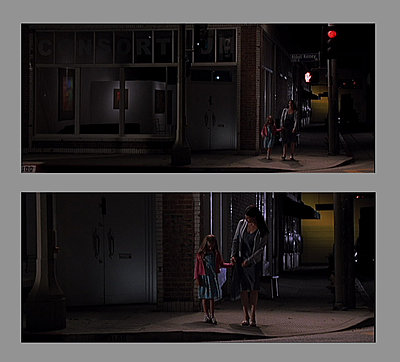

While it is certainly true that long cable runs do require manpower and time (and other safety issues), even these can be worked around in the low budget/creative realm. A series of small units in the background could be powered via inverters in strategically parked cars (there are some powerful spotlights that are designed to plug into cigarette lighters that could be used), eliminating cables. A big fat backlight as you describe is effective for separation but it does present its own problems--over a long walk-and-talk there will be significant falloff (something that a series of smaller backlights can resolve, even if mounted next to each other; one flooded for close range, another spotted and aimed further down the street etc).
I just re-read the first post, and I see that that the game is to achieve a "dark look with minimal light". I saw MI3 but don't remember the look of the referenced scenes. I would however hazard a guess that a big wash of backlight may not be the desired effect for something like this, so I might stick to my recommendation of illuminating the background with pools or rakes of light so that there is texture throughout, and allowing the subject to play in halflight, under-exposed front fill and/or rim light to taste.
As an example of a number of small units lighting a good size area, I submit the attached frame grabs from something I shot a few years ago. I believe the largest units were 2K open faces through a large diffusion frame that were on top of the gallery that mostly played out into the street for a subsequent scene. Otherwise, I believe everything else was 1K or under, except for the edge light on the buildings behind the characters which I think was two 1200 HMI's.
How to shoot an outdoor night scene that is suppossed to look dark (ie unlit)-instant-car.jpg
