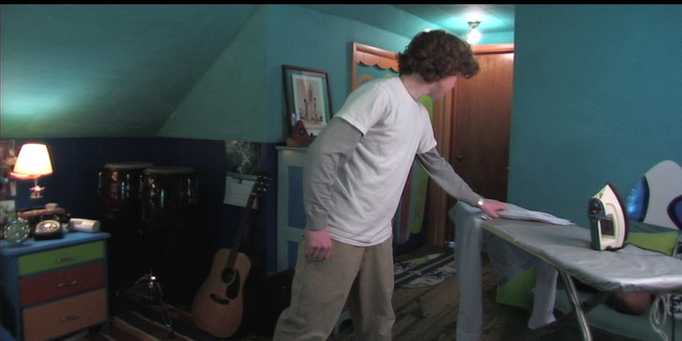

Stephen,
Another way is to use a china ball to bring up the overall level of the room.
In this scene I left the practicals on (maybe a bit hot) and filled the room with a china ball. It maintained the over all look and allowed the talent to move anywhere within the room.
Another advantage of the china ball is that you could hang it on a pole and have it follow the camera if you are in a larger room and have bigger camera movements than I did here.
As with any light source you will need to flag it to remove unwanted spill.
Bill

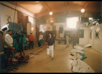

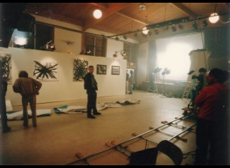

Posts: 1,261
we had a Art Gallery scene that we had to build a set because there was 5 min dialogue and Art Galleries just had too much noise ( coming from exterior) ...
shot it at local community center ... just used a wall of flats ( rented from theater)... added a little smoke, lighting, & sound blankets on floor ...
shot on 16mm ..ASA 100 film .. zeiss 10-100 T2 lens ..shot at T2.5
Don Donatello is offline   Reply With Quote
