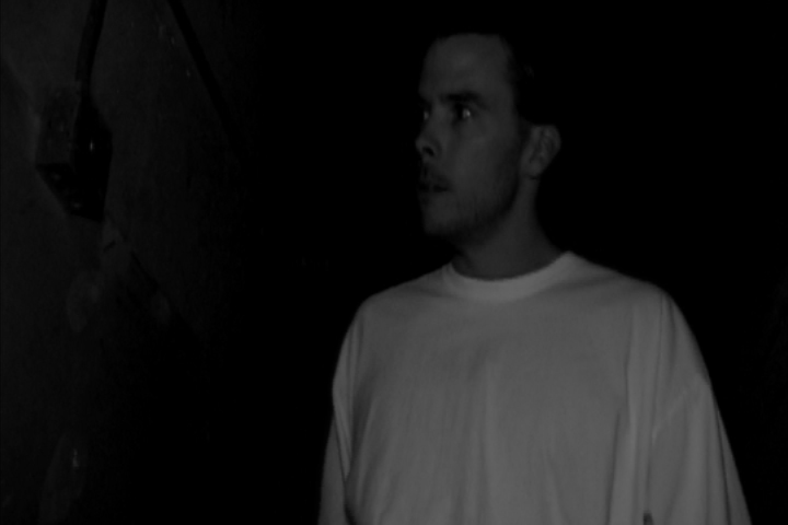

Attached is what I have so far for a test render screen grab. It was with the VX2100 and using 20 watts on cam. halogen. Aperature was open with zero gain and shutter at 60.
The great part is that my character wears a white t-shirt!

The trouble is, having the light mounted on the camera, pointing at the subject head-on, makes it look just like poorly lit amateur footage (at least it does to me).
Any light you do use should come in at an angle, giving you shadows on the face to emphasise the darkness. More back-lighting, less front lighting. Yes, having a strong back light comes from an unmotivated light source, but, technically, so does your front light.

Not to mention that as the light level falls, the first thing to go is the chroma part of the signal.
Your screen grab appears totally devoid of any color. Which is typical of inadequate light levels.
I think you said you're doing a horror/suspense film. If so, and you have any blood, it's going to look like chocolate syrup in this kind of lighting.

IMO forget the all white t-shirt .. unless you can get a 50% reflective or lower white .... as you can see from your photo - take away the white T shirt & the person is in darkness - the white T shirt takes away the darkness look - you could end up with many shots only seeing the white t-shirt surrounded by pitch black ...
