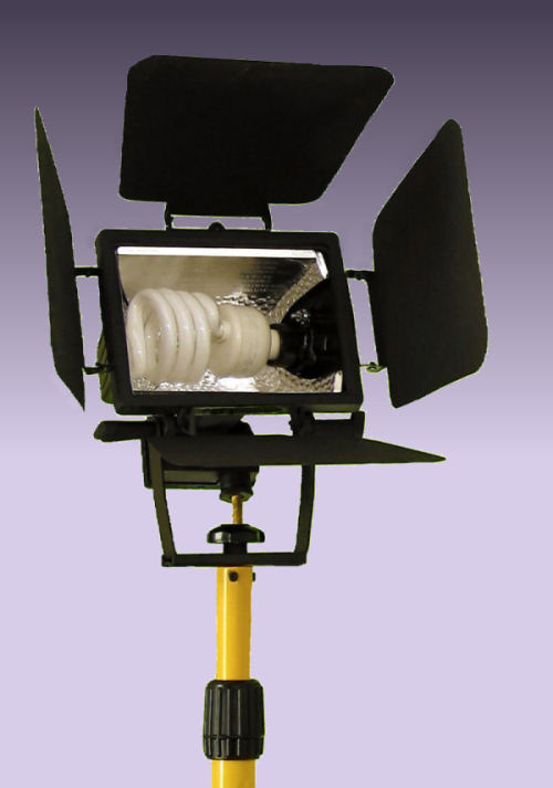

How about a fluorescent spiral in a worklight fixture with barndoors attached. Looks confusingly like a video light almost doesn't it. LOL...
On the 60w LED I'll post pictures soon of the LED and the fixture I've chosen for it too.
Shooting with Compact Fluorescent Lights (CFLs).-halogenconversionlavenderbkgd.jpg

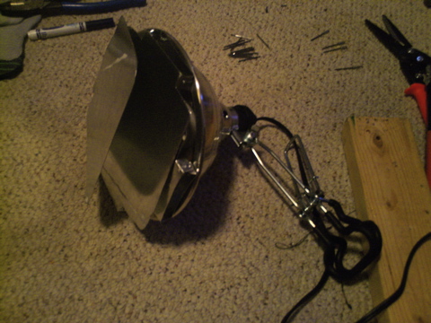

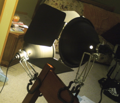

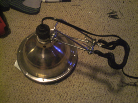

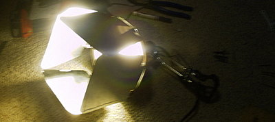

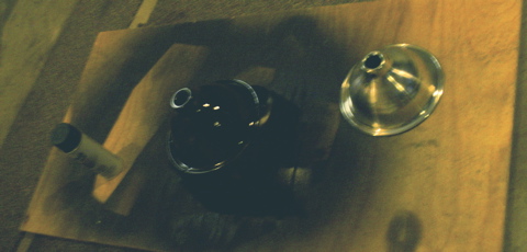

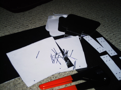

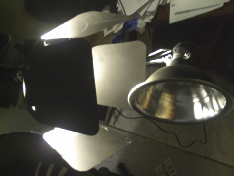

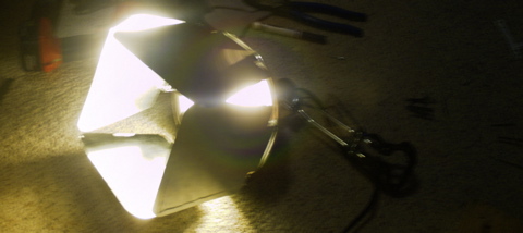

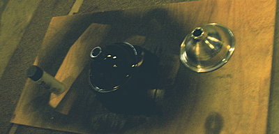

Just finished adding barndoors to my clamps
Note the ACDelco neck attachment is by bolt, not by friction knuckle...I've gone through 10 of the knuckle based lights, but still use the same 5 ACDelcos! Paint is high heat paint for grill interiors. Bulbs are CFL GE Softwhite bulbs. They have wattage equivs up to 250 tungsten watts.
Shooting with Compact Fluorescent Lights (CFLs).-barndoors-1.jpg   Shooting with Compact Fluorescent Lights (CFLs).-barndoors-2.jpg
Shooting with Compact Fluorescent Lights (CFLs).-barndoors-3.jpg   Shooting with Compact Fluorescent Lights (CFLs).-barndoors-4.jpg

Wow, good job. Just like the one I did ;-). So your bulbs are drawing 60 actual watts? That's a pretty big one. Didn't know there were GE ones that big yet.
Looks like you decided to use all rivets. I'll be interested to hear how that goes. I found that with the thin aluminum fixtures, its better to attach the hinges to the worklight with machine screws, nuts and lock washers. More secure. Also, looks like you decided not to add the compression spring and wing nut to one side of each hinge. Sometimes I found that the rivets (after much movement of the barndoors) become too loose and the upper and lower barndoors (which are subject to gravity more don't stay in place as well). Hence the reason for adding a machine screw, compression spring and lock washer on one side of the hinge and rivet on the other. Allows tightening up the movement should it get too loose.
If you have time, could you post those pictures in my forum under the user articles DIY section? See link below:

I don't have the screws because the hardware store was closed when I decided I wanted the screws...they're open now and pop rivets are both cheap and easy to remove...after one night, I've already got some play in one of my hinges, so I'm switching it over.
