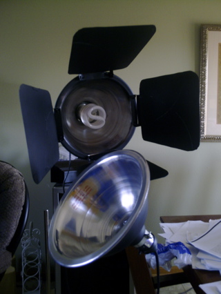

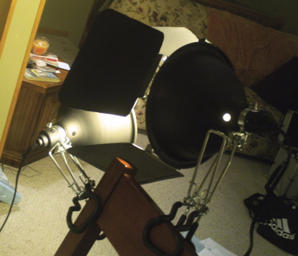

I use ACDelco Worklights with GE Softwhite screw in flourescent spiral bulbs. They work like a champ, I'm currently putting on barndoors using the http://www.coollights.biz plans and have painted them with flat black high temp spray paint.
I also have some gels and a roll of parchment paper, a china ball with a bare socket, 5 craftsman 500w worklights (clearance ;) ) few sheets of foamcore, some black seethrough fabric with a fine weave for scrimming windows etc...black smaller foamcore for flagging lights, bunch of various old stands from rummage sales and auctions. Tent pole with screws through it that set into 2 lighting stands to make a cross bar for adding a backlight behind. cords, adapters, circuit testers, leather gloves.
I have a 0 budget for lights!-lights.jpg   I have a 0 budget for lights!-lights2.jpg
