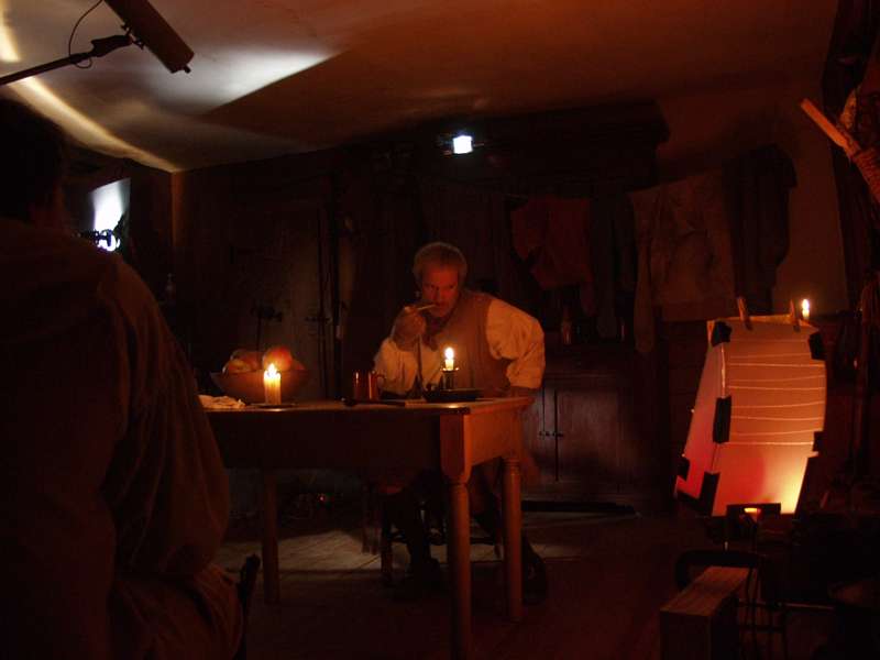

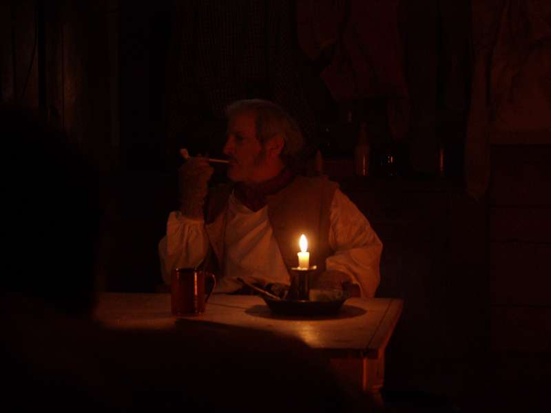

When he blows out the candle it's all the candle, when you see him looking around in the wide shot the set is dimmly lit the reflections on his face is all the candle.
Here are a couple of stills, I had to hand hold at a 1/10 of a secod to get them.
The wide shot of the set shows our accent lights the make shift foamcore softbox gives the flickering light from the fire place.
a closer shot shows the candle light on the talent.
Isn't low light fun!! :-)
Bill
