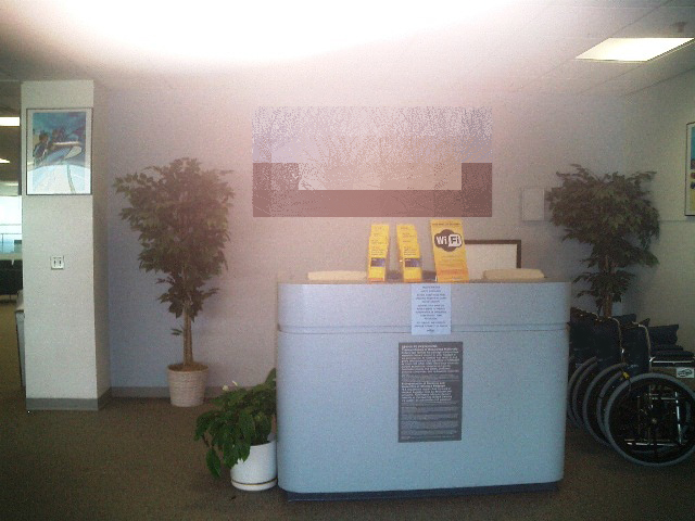

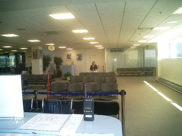

If it helps, here are a couple of picture of the location (crappy pics, I didn’t take them). The second shot shows the counter (side view, far end of the room) behind the woman (look for the two tall standing plants). The other pic is a head on shot of the location. One actor will be behind the counter, the other in front. Also notice the windows which will be behind the 'customer' standing at the counter.
If I use a 1K Arri fresnel(s) with CTB and diffusion, how far will that knock the light down -- and do think it would be effective? Or should I go with CTB and bounce off of a white board?
I agree, I think the biggest problem might be the windows and the amount of light coming in..
Any other suggestions based on the pics? Any specific set up ideas as to lighting two actors as mentioned above?
Thanks again for all of the input.

This is all subjective, of course, but I'd be more concerned about the overhead florescents at least in the area right around the action. Even if you can't turn all of them off, can you twist out the tubes in the area where you are working? Or maybe tape showcard over them? Then you can work with the windows to light your scene. From the pictures, it looks like you can frame your shots such that the windows just peek into the frame and provide a motivation for your lighting.

1. You must tame the daylight. You can do this by shooting at a time when the sun is not directly hitting those windows AND OR you can set up some duvetine on a couple of C-stands near the windows, just out of frame. You don't need to kill all of the daylight coming in, you just need to shade the area your actors are in as well as a bit behind them. When you said you cannot black out the windows, I assumed you meant you can't ND them or place black showcard over them, but I assume you can build a small "light block" with duve and a couple of C-stands for just the time you are shooting?
Other options would be to rent HMIs or cheaper and easier, daylight balanced Kinos. You can fight the light or you can go with it. It's easier to adapt your lighting to what's outside that window but if it's blasting through the window, depending on the angle of the sun, you must tame it anyway, one way or another.
2. As far as the fluoros, good suggestions already here. Once again, if you manually white balance, if you cannot block or kill all of the overheads in your area, a little green fluoro bleed won't kill you and if you use a medium Chimera or something larger like that size as your key source, you can probably further block the amount of light from the overheads that actually makes it into your scene.
