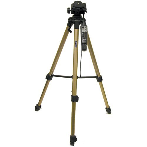

In one of those odd cosmic coincidences, I received my B&H Package with my A1 on the same day that we got a new XL2 at work. The XL2 came with one of the cheap NY "Extras" kit (the lens cleaning kit, the $10 tripod, and an invitation to turn your grey market import into a real camera).
However, this one surprised me. The "el cheapo" tripod came with a LANC controller that ACTUALLY WORKED on the XL2:
focus
zoom
selectable zoom speed
camera on/off
record
I checked and the list price of this beauty is about $50 on amazon.com. I was able to easily remove the handle and use it as a standalone LANC controller for both the XL2 and A1.

Digital Concepts 63'' Tripod with 8 Function Remote Control
I tested it again and it has two focus buttons "near" and "far" that push the focus in that direction. it does not have "push auto" focus. Again though, for $50, that sounds a lot cheaper than Canon's $400 or the prosumer LANC controllers in the $250-$300 range.
