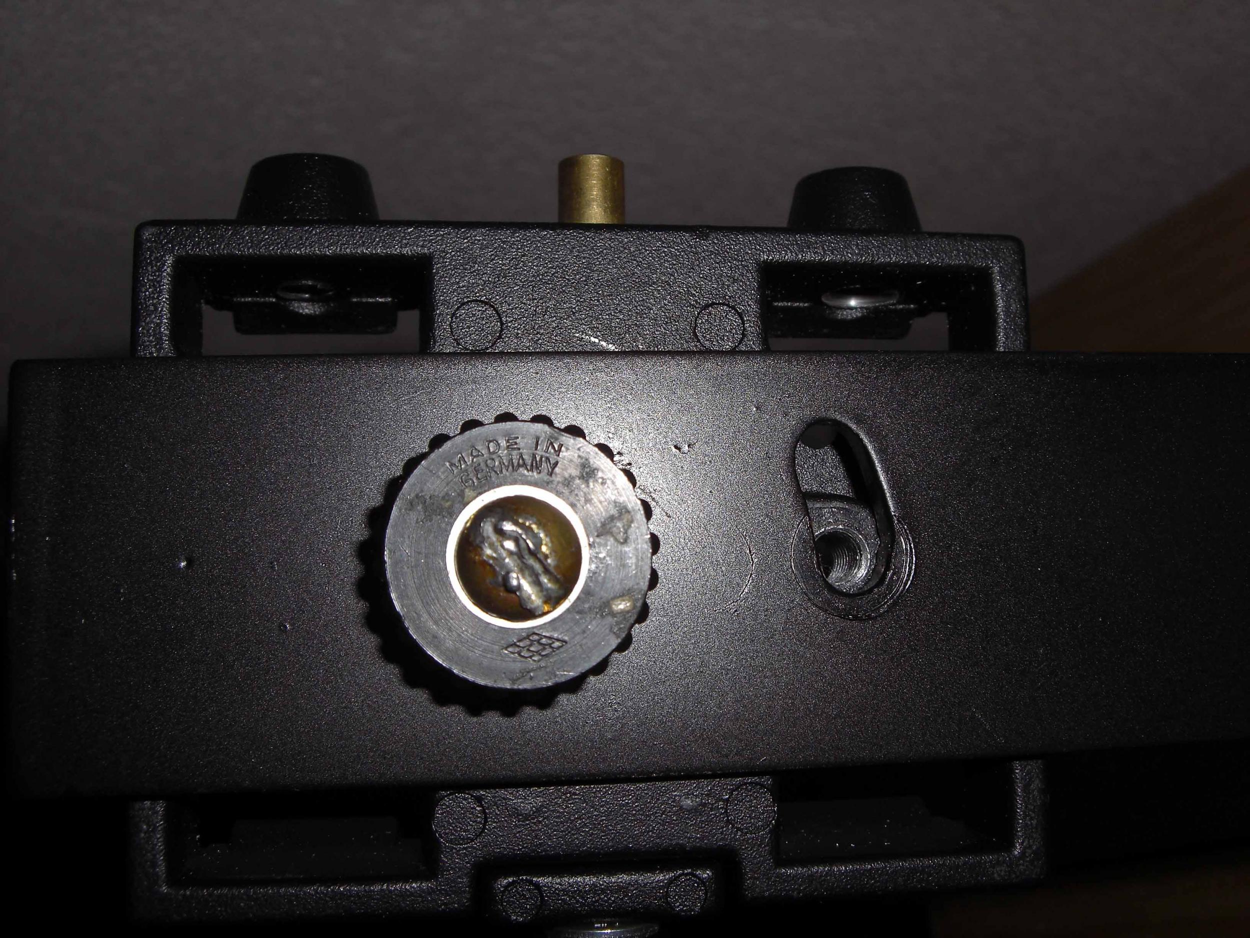

I am custommaking one now and made a wider wooden shoulderpad which is 10cm wide so it's much more stable on my shoulder and i ordered a hood-pro with sock loupe to attach to my lcd so I can use my lcd as a viewfinder.
Noa,

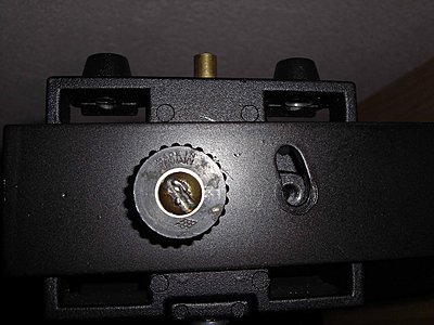

I have made my own shoulder mount, and I managed to use the viewfinder in stead of the LCD. This is how I did that: In the bottomplate of them 577 there are two threaded holes. Now if you would make 1 normal hole and one slotted hole in the tip of the shoulder mount, you could use your standdard viewfinder. The camera can be slightly rotated on the tip of the CB105.

Jo, if you rotate the camera does it not stand at an angle then? I allways thought the only way to get the camera in front of your eye with an cb105 alike shouldermount is to offset the camera using an extra u-shaped bracket.

No, it realy works! Indeed, the centre line of the cam makes an angle with the centre line of the shoulder mount, but in fact that is what I realy wanted. Only thing I had to take care of, is that you need to take the dimension from Vf till center of the Quick Release into account. It would be inconveneant if the VF ends up 2" from your eyebrow, don't you think?

Hi Jo, I'm a bit curiuos to see how exactly you build it, would it be ok for you to post a photo how you made it with the camera attached to the cb105?
