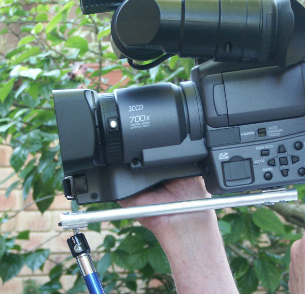

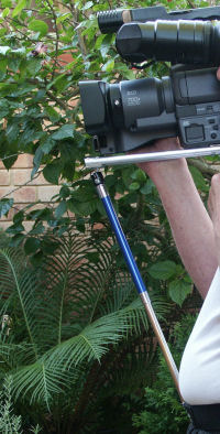

Old May 20th, 2010, 04:53 AM   #4
Posts: 8,441
Hi All
I decided to make a quick rig and body support for my camera and it works like a dream!!
It's basically an aluminium rail under the camera with a plate at the end. Into the plate is a tiny ballhead (I ripped it out of one of those little bendy legs table tripods) and that is simply bolted onto an adjustable arm (also a telescopic Optex still camera tripod leg) Around my waist I have a camera shoulder strap which has a pocket cut into it and the other end of the rod sits in there.
This takes all the weight off your shoulder mounted camera and provides great stability!! It would be an excellent addition for a shoulder mount rig too!!
Pics are below
Chris
